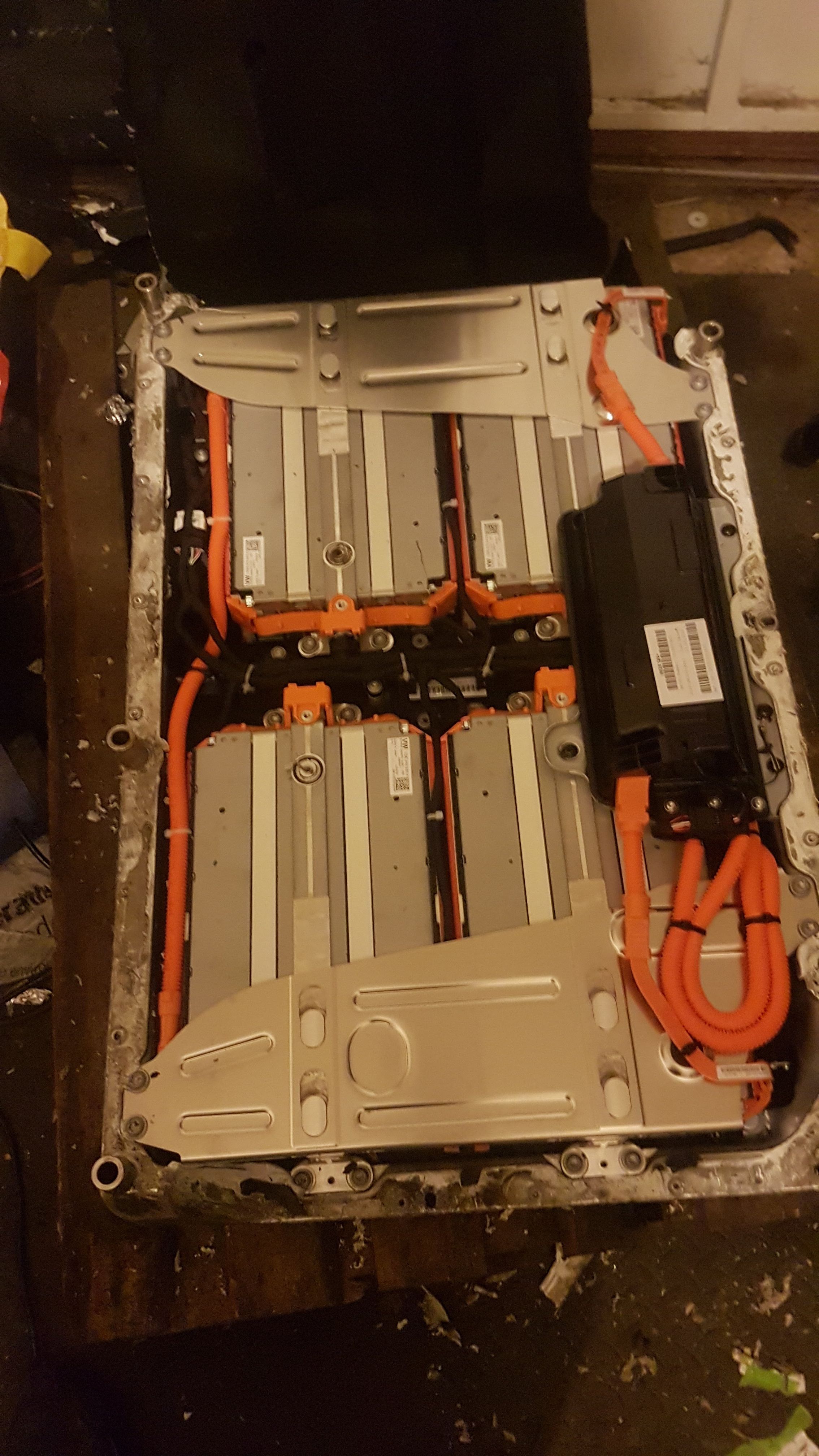

After Undoing all of the torx bolt on the top the cover can be removed … look at those precision straps to hold the modules down.
At this point after prodding about underneath the foam and looking down the sides I need access to the bottom to unbolt the modules, find that un-loved screwdriver (covered in paint in my case on top of my daughter’s rabbit hutch) and use gentle persuasion to remove the rubber plugs to get access to the torx bolts and remove them. Be very careful this thing is damn heavy you don’t wan this to land on your toes or any part of your body
Now back to the top side … remove all the foam, disconnect all of the cables you can (I could not remove the module bms plugs). Happily my module sat at 355 volts (88.8v per module) so not too low at about 3.7v per cell!
I then started tackling all of the bolts holding down the modules in the middle, however then came the ones that were under the Contactor box.
The scary bit where I disconnected the HV connections from the Contactor box thing, immediately covering with insulation tape, first negative, positive, then I tackled the mid pack connection (not shown in this photo). Then I removed all of the connections from the contactor box to allow it the removed to allow access to the torx bolts obstructed by it.

The same safety advice as above applies, these packs are over 350V DC, this can be LEATHAL. DO NOT BE COMPLACENT.
The Golf GTE pack is a heafty aluminium box with a plastic lid. The lid is covered in a very thin aluminium layer. I found it quite a task to break in, there's a lot of silicone around the perimeter. I used a mixture of breaking the cover and levering it up as much as possible and cutting the silicone.
Under the plastic is a blanket covering the modules. The goodies are underneath. none\thumb
