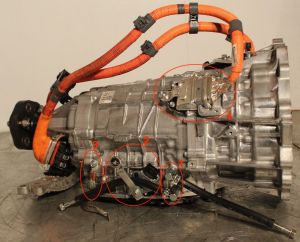

Connections
Left hand side
Left hand side connections
  1. MG1 3-phase power connection
  2. MG1 resolver (and temperature) port
  3. MG2 resolver (and temperature) port
Right hand side
Right hand side connections
  1. Water input/output for oil to water heat exchanger
  2. Mechanical shifter and shift sensor port
  3. Ground strap
  4. MG2 3-phase power connection
