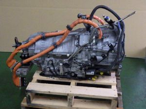

Lexus GS450h Toyota/Lexus Lexus GS450h L110 RWD Popular conversion project motor, the GS450h has two motors as part of a gearbox mated to an ICE engine. MG1 and MG2, one of which is generally used to start the ICE, the second used to provide drive to the wheel in electric only mode.
The input shaft from the ICE can be secured and both motors can then be used to drive the output shaft.
The popularity and conversation around it comes from the fact it is likely to occupy the same space as a rear wheel drive gearbox leaving the majority of the engine bay free and obviously joining to the existing rear propshaft.
