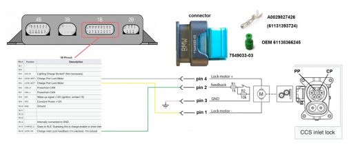

The charge port lock should work with the Duosida lock as well but the feedback (1k unlocked, 11k locked) is a bit different which requires some additional resistors. | The charge port lock should work with the Duosida lock as well but the feedback (1k unlocked, 11k locked) is a bit different which requires some additional resistors. | ||
[[File:CCS setup LIM 2-02.png|none|thumb|CCS inlet lock]] | [[File:CCS setup LIM 2-02.png|none|thumb|CCS inlet lock]] | ||
[[File:I3 ccs port wiring.jpg|alt=i3 locking actuator wiring|thumb|509x509px|i3 locking actuator wiring ]] | |||
If using an OEM BMW i3 CCS charge port, the [https://openinverter.org/forum/viewtopic.php?p=32096#p32096 Kuster lock uses connector BMW 12527549033], [https://www.fcpeuro.com/products/bmw-socket-housing-4polig-12527549033 around USD$4]. | If using an OEM BMW i3 CCS charge port, the [https://openinverter.org/forum/viewtopic.php?p=32096#p32096 Kuster lock uses connector BMW 12527549033], [https://www.fcpeuro.com/products/bmw-socket-housing-4polig-12527549033 around USD$4]. | ||

Connector for BMW i3 CCS plug locking actuator is BMW part number 12527549033. Pins and seals should be the same as used on the LIM module.
Wiring Diagram
Wiring notes
Make sure you mount the LIM as close to the charge socket as possible and keep the pilot wire separate from the high power wiring.
Bad pilot wiring can result in SLAC, PLC, or other communication problems.

Charge port lock
Only important for Type 2 (3-phase) charge ports.
In the BMW i3 a quite expensive Phoenix CCS charge port is used and it would be nice to be able to use the cheaper Duosida CCS charge ports.
If using an OEM BMW i3 CCS charge port, the Kuster lock uses connector BMW 12527549033, around USD$4.
