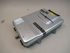

The Tesla GEN2 charger is a single/three phase 10kW AC charger that was fitted in the Model S from 2012 until it was replaced in the 2016 'facelift' model with GEN3.
One or two GEN2 chargers are installed beneath the rear seats in the model s for ac charging.

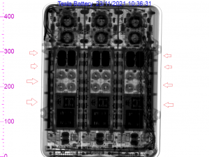

The charger is made up of three 3.3 kw modules, each sitting on a liquid cooling plate. This assembly enables both single and multi phase ac charging.
Charger Dimensions: 500x300x100mm

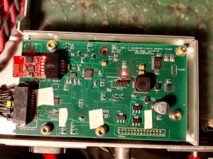

Replacement control boards
replacement control board https://github.com/damienmaguire/Tesla-Charger
v5 kit: https://www.evbmw.com/index.php/evbmw-webshop/tesla-boards/tesla-gen-2-charger-logic-board-kit
v5 partially built board: https://www.evbmw.com/index.php/evbmw-webshop/tesla-boards/tesla-gen-2-charger-logic-board-partially-built
github: https://github.com/damienmaguire/Tesla-Charger

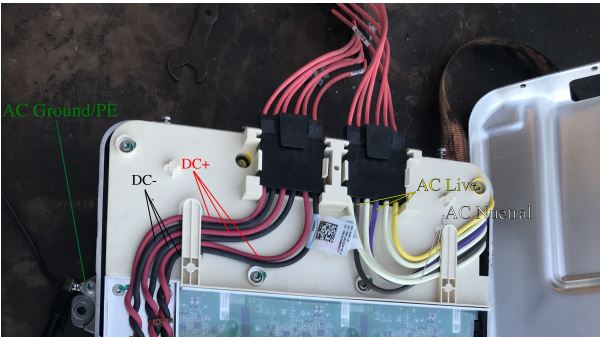

AC and DC power connections (Molex Sabre series):
- housing: 044441-2006
- pins: 043375-3001 (18-20AWG), 043375-0001 (14-16AWG)

External CAN bus
The V5aB2 version of the board has no connection to the external CAN bus (V5aB3 has) but you can add it with to bodge wires as shown in the picture. You will find CANH and CANL on the 3 pin header underneath the WiFi module. Route them over to CONN6 as shown. CONN2.1 (CANH) is connected to CONN6.24, CONN2.2 (CANL) to CONN6.26.
Revision V4aB3 does not need this modification. If you do NOT use the external CAN bus on that version remember to close the solder jumper next to R1 under the WiFi module.
If the charger is the first/last device on your CAN bus there is nothing else to do. If it is somewhere in the middle you have to remove the bus termination resistor R1.

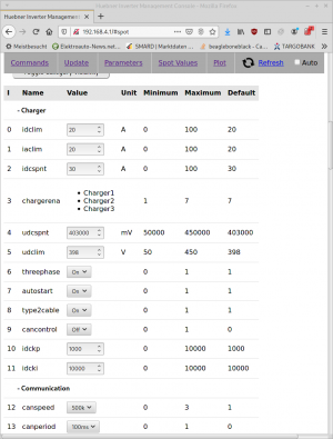

Commercial charger firmware
In addition to the open source firmware there is also a commercial firmware. It adds advanced features:
- Support for the standard open inverter web interface
- Parameter handling as known from the inverter firmware (see picture)
- Spot value handling like inverter including plotting, gauges, and logging
- Over the air update like inverter
- DC current control
- CAN control as described above
The firmware requires the board to be flashed with stm32_loader.hex. An Olimex MOD-ESP8266 must be programmed with the openinverter web interface. See Olimex MOD-WIFI-ESP8266 and this forum thread for flashing instructions. With that done, future updates will happen via the web interface.

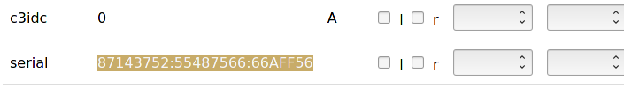

Registration
If you bought a fully assembled V5aB3 board from the EVBMW webshop you can skip this step.
The firmware will work without registration but charging time is limited to 5 minutes. To overcome this, a board-specific pin must be bought. In order to do this the firmware and web interface must be installed and working.
Go to the openinverter webshop and check out as many pins as you need. When checking out add the serial number(s) of your board(s) in the order option. You will find the serial number on the bottom of the page as last spot value.
You will then receive an email containing one pin for each board. Enter the pin in the web interface in the "pin" parameter. When the pin is correct it will be automatically saved to flash and your board is ready to be used.

Parameters
The firmware exports a number of parameters to be modified by the user. All modifications are temporary until you hit "Save Parameters to Flash" at the top of the page.
We will go over all of them.
