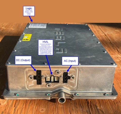

Connectors
Charger Connections
There are six discrete connectors on the GEN1 OBC. In typical applications, they are not all in use.

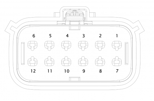

Logic Connector X042
The Logic Connector X042 needed to plug into the charger is Molex 19418-0026[3] which is in the MX150L series.
Molex 194180026, female connector to mate with X042 Logic Connector on Tesla GEN1 OBC.
Logic Connector X042, 12-pin
Pin No. Function Description
1 12v supply
2 Charge Port: nozzle lock "InsertEN out"
3 HVIL Out
4 CAN +
5 EVSE-Pilot (CP)
6 FC CAN (SWCAN?)
7 12v GND
8 Drive inhibit "Prox out", signal to DU to inhibit drive
9 HVIL In
10 CAN -
11 EVSE-Prox (PP)
12 "BMS_12V_in" (BMS enables charger?)
Input/Output Connectors
Tesla Model S GEN1 OBC Power Connectors
AC (Input) Connector Xnnn
The AC Input Connector housing needed to plug into the charger is Molex 42816-0412[4]
Molex 42816-0412 housing, 4P, for AC Input.
The female terminals for this housing are Molex 42815-0134[5] for 8 AWG (8mm²).
Molex 42815-0134 female terminal, for 8AWG (8mm²) wire.
DC (Output) Connector Xnnn
The DC Output Connector housing needed to plug into the charger is Molex 42816-0312[6]
Molex 42816-0312 housing, 3P, for DC Output.
See above AC Input Connector for terminals reference.
