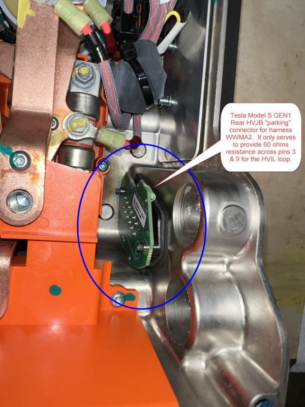

The below two pictures show the GEN1 Rear HVJB's Lid Reed Switch:
Closeup of Tesla Model S GEN1 HVJB (under rear seat), lid removed, showing the HVIL cover reed switch and HVIL connector that connects to a mating connector on the OBC.
Telsa Model S GEN1 Rear HVJB: harness WWMA2 "parking" connector which contains only a 60 ohm resistor. This connector is used when a Tesla does not have a Second/Slave OBC.
Telsa Model S GEN1 Rear HVJB: front view of harness WWMA2 "parking" connector which contains only a 60 ohm resistor.  This connector is used when a Tesla does not have a Second/Slave OBC.
Tesla Model S GEN1 Rear HVJB (under rear seat), lid removed, showing the HVIL cover reed switch and HVIL connector that connects to a mating connector on the OBC.
Telsa Model S GEN1 Rear HVJB: rear views of harness WWMA2 "parking" connector which contains only a 60 ohm resistor.  This connector is used when a Tesla does not have a Second/Slave OBC.
Telsa Model S GEN1 Rear HVJB: rear view of harness WWMA2 "parking" connector which contains only a 60 ohm resistor.  This connector is used when a Tesla does not have a Second/Slave OBC.
