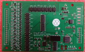

The goal of this BMS is to use mostly decade old components to create a 16 channel cell voltage meter. It uses a very accurate sigma/delta ADC for superb resolution. It can drain about 100mA from a cell or charge it with 50 mA via the DC/DC converter. The ability to both charge and discharge cells speeds up balancing despite the low balancing current.
When turned off it drains no current from the connected cells at all.
On the low voltage side it features two inputs for temperature sensors and one input for a 5V current sensor, differential or single ended.
It can be cascaded to be used with more than 16 cells and has an automatic addressing scheme to forgo the use of jumpers or DIP switches. All communication is done via CAN. Supply voltage is 12V with about 20 mA draw when not balancing.
The software is not yet finished, see forum for progress [1]
Pinout
The pinout is also written to the bottom silkscreen.
On the left side you see 17 inputs. The first one is connected to the negative pole (GND) of your (sub)pack, the subsequent ones to the positive poles of up to 16 cells. At least the lower two cell inputs must be connected. When cascading modules the positive-most input of module n is also the GND of module n+1, so must be spliced to connect to both.
On the top right is the vehicle interfacing or low voltage connector. From top to bottom it is low voltage GND, 12V, enable_in, enable_out, CANH, CANL. GND, 12V, CANH, CANL are connected to all modules in parallel whereas enable_out is chained to enable_in of the next module. The first enable_in must be connected to 12V whenever the BMS should become active, e.g. when charging or driving. The module with 12V on the enable_in auto-detects as "main" module, collects data from the subsequent modules and sends more high level CAN messages
On the bottom right is the temperature sensor and current sensor input. Top to bottom it is tsensor1+, tsenseor1-, tsensor2+, tsensor2-, 5V, CUR+, CUR-, GND. A single ended current sensor is just connected to CUR+.
Right now the current sensor is only supported on the main module and only one temperature sensor is supported.
