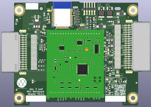

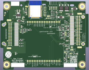

If you scanned the QR code on your gen 3 Leaf adapter board you are in the right place to help set it up!
This adapter board is compatible with Gen 3 Nissan Leaf (model year 2018+) inverters and the open inverter mini main board
This is a work in progress...

There are optional jumpers on both the adapter board and the mini mainboard.
Setting up the mini mainboard jumpers
SJ1 (mini mainboard back) should be **soldered / not soldered.**
This enables a 500 ohm pull-up resistor that is needed for open collector encoders. In the case of the EM57 motor it **is / is not required**.
SJ3 (mini mainboard) soldered to the left is setup for cruise control 12v input. It should stay like this.
Soldered to the right is 3.3v MOSI for SPI communications. Do not apply 12v to this input while shorted to the right of the jumper or damage likely will result.
Setting up the 3rd generation Leaf adapter board jumpers
SJ4 can be ignored. It should stay connected.
This jumper allows disconnecting the brake output circuitry from the board address circuitry for testing (see Mini Mainboard Hardware Detection.) **add link** This IO is shared between a board address analog input and a brake light output. Once this is proven out there should be no need to change this jumper.
SJ5 - Open Inverter has an Emergency Stop (E-Stop) function to quickly, non-destructively, and safely shut down the inverter. To use the E-Stop option connect an E-stop switch (closed when OK, open in stop position) that feeds 12v to position 40 of this adapter board. The E-Stop switch must break the 12v signal of the circuit when the e-stop is pressed or if a wire breaks. Other methods are not recommended for safety - to verify it shuts the inverter down when needed. To ignore the E-Stop functionality, solder the SJ5 jumper closed. No need to populate position 40 (e-stop signal) in this bypassed case.
You must either feed in 12v on pos. 40 or solder SJ5 closed to feed12v into this E_STOP input or the inverter will not run.
SJ6 is optional and can be left with both positions open. Never short all 3!
Position 19 on the 40 position Nissan connector is a PWM_USER / OUT_TEMP signal. Part of the PWM_USER circuitry is an optional pull up resistor (R19) that is not populated. An 0805 SMD resistor can be added if a pullup is desired on board (the footprint is for a hand solder 0805, it's larger than normal but makes it easier to modify and hand solder.) SJ6 is a voltage select solder jumper to select between the onboard voltages of 5.3V and 12v. There is also a plated through hole labeled as UV1 (user voltage) to be used for the pull up voltage if desired.
C11 capacitor is to reduce EMI. If your PWM device needs a very sharp edge this may interfere. C12 is a 1uF capacitor to help stabilize the user selected voltage. The n channel mosfet is rated for 100v and 1.5 amps. This is a common footprint with a wide range of voltages and currents up to about 1.5 amps.
SJ8 / J8 is a voltage select solder jumper in the case of SJ8 and a 3 position make pin header in the case of J8. You must use one style jumper to select 3.3v or 5v for your programmer. See programming the ESP32 below for further info on programming.
SJH1 & SJL1 These should be either both soldered if a 120ohm CAN termination resistor is desired here. Do not leave one solder jumper open & one closed. If this is the end of a CAN line these should both be soldered.
There is a capacitor in the middle of the 2x 60 ohm resistors to help filter noise on the CAN lines. There is also a TVS diode (D6) right next to the 40pos. connector to help with static protection.

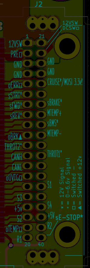

40 position Leaf connector modifications
If you are using the factory Leaf 40 position connector there are many open inverter specific wires that need to be added.
**add which pin numbers or mark them somehow in the table below**

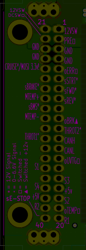

40 position connector pin out:
The adapter board is labeled at the 40 positron connector to help with wiring up the inverter. Images of these are to the right and a table is below with the positions in order.
The surface mount version of this connector starts with position 21, then 1, 22, 2, etc. The position labeling is offset slightly on both sides to help with this.
The pc board renderings / pin labeling can be used to help populate the connector and write the vehicle.
Pos. | Abbreviation | Description | AKA | Details | Pos. | Abbreviation | Description | AKA | Details | |
1 | +12VSW | Switched +12v | 21 | +12VSW | Switched +12v | |||||
2 | PRE□ | Precharge contactor switched ground | 4.5 amps recommended to use an economizer | 22 | DCSW□ | EV battery contactor switched ground | 4.5A recommended to use an economizer | |||
3 | GND | Ground | 23 | GND | Ground | |||||
4 | GND | Ground | 24 | GND | Ground | |||||
5 | oERR□ | Output - Error signal, switched ground | 1 amp | 25 | CRUISE*/MOSI3.3v! | Cruise control signal 12v / MOSI 3.3v | 12v set as cruise. 3.3v as MOSI | |||
6 | sSTRT* | Input, 12v start signal pulse | 26 | empty | empty | |||||
7 | sFWD* | Input, 12v forward | 27 | sBRAKE* | Brake light input 12v | |||||
8 | sREV* | Input, 12v reverse | 28 | MTEMP+ | Motor temp senor + | |||||
9 | empty | empty | 29 | sBMS* | Battery Management System error +12 signal | |||||
10 | oBRK▲ | Output, brake +12v (see SJ4) | 1.5 amps | 30 | MTEMP- | Motor temp sensor - | ||||
11 | THROT2° | Throttle 2 0-3.3v signal | 31 | empty | empty | |||||
12 | CANH | CAN high signal (see SJH1) | 120 ohm termination resistor solder jumpers | 32 | THROT1° | Throttle 1 0-3.3v signal | ||||
13 | CANL | CAN low signal (see SJL1) | 120 ohm termination resistor solder jumpers | 33 | empty | empty | ||||
14 | oUVTG□ | optional output? 1amp max switched ground | 1 amp | 34 | empty | empty | ||||
15 | empty | empty | 35 | S1 | Encoder S1 wire | |||||
16 | S3 | Encoder S3 wire | 36 | empty | empty | |||||
17 | +5V | +5V for sensors (like throttle) | 37 | S4 | Encoder S4 wire | |||||
18 | S2 | Encoder S2 wire | 38 | +5V | +5V for sensors (like throttle) | |||||
19 | oTEMP□ | over temp signal, switched ground, 1 amp max | 1 amp, has EMI filter capacitor (C11) for PWM | 39 | R2 | Encoder R2 wire | ||||
20 | R1 | Encoder R1 wire | 40 | sE-STOP | Optional Emergency stop switch (see SJ5) | Can add an E-Stop switch to 12v. |
