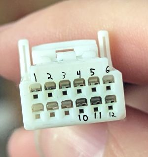

Data Connector on PCS (12-way)
EDITOR'S NOTE: my research shows some conflicting/different part numbers mentioned - would appreciate some clarification here once validated
As per: https://openinverter.org/forum/viewtopic.php?p=26614#p26614
The connector used for communications with the PCS: [2][3]
Pins: [4]
In true Muskian fashion it seems they use the 1379662-5 natural color variant of the plug which has no coding tabs. It is of course unavailable from mouser. The black and green variants are functionally identical and should work with coding tabs removed.
However, as per: https://github.com/muehlpower/EV-FFB, there is also mention of 1318774-1 (white) or 1318774-2 (black) for the comms/data connector.

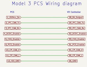

The minimum wiring needed to wake the PCS:
- PCS controller connected to PCS via 12-way X420
- PCS controller is powered via 20-way +12V input pin and grounded to chassis via 20-way ground pin
- +12v and Chassis ground applied to PCS 12v Connector input terminal
- Chassis ground on the PCS case

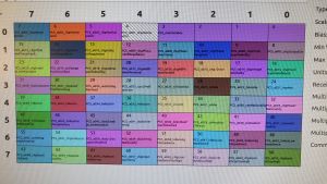

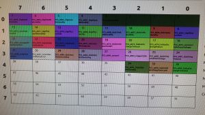

The PCS has an array of potential alerts to help diagnose issues. The images below show a matrix of potential alerts
Initially alerts had to be identified through CAN logs (PCS IPC CAN). In later firmware releases, the PCS web interface incorporated a decoder to help identify alerts (decimal number identifier relating to the alert tables shown here). In the current version of firmware, the alerts are now displayed in word format to make it easier and quicker to troubleshoot.
Below is a list of all alert codes the PCS can generate, with associated error code number, and plain text descriptions of what each one means

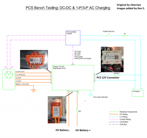

First Power Up
Set up to initially test connections between a PCS and the PCS controller are straightforward. This can be done without any HV DC battery or charging connected to the PCS. Once the PCS controller is connected to the PCS (follow the relevant V2 or V3 pin-outs) the basic steps are:
- Connect the PCS aluminium case to LV ground
- Connect PCS controller ground wire to 12V ground
- Connect PCS 12V power wire via a 5A fuse to +12V
- Observe the PCS controller continuous 3.3V indicator red LED and the flashing activity red LED
- Connect to the PCS controller wifi (SSID will be, for example , ESP-DC87FA) to view the web interface (v3 has a default IP address of 192.168.4.1). The interface will indicate that the PCS 'opmode' is 'Off' at this time
- On the web interface, change 'inputype' to 'Manual' in the drop down menu and select refresh at the top of the screen
- On the web interface, change 'activate' to 'Both'. This will tell the PCS to try start DC-DC and Charging if enabled (as above, these are not connected at this time so will generate alerts that will be mentioned further below)
- On the web interface, change 'AlertLog' to 'On'. This will tell the PCS to show any alerts
- To enable the PCS connect the PCS controller 'Input 1 (enable)' wire to +12V and select refresh at the top of the screen. 'Opmode' should now change to 'Run' on the web interface to show the PCS is now operational
- At this point, 'PCSAlertCnt' will likely show a number indicating the number of alerts the PCS has flagged and 'PCSAlerts' will show the first alert
- To see each alert separately, under General, change the number in the 'Alert' option (0 indicates first alert and should be default) to the next sequential number and select refresh at the top of the screen. 'PCSAlerts' will now show a description of the selected alert. Do this to step through each alert (total number indicated by 'PCSAlertCnt')
- Typical alerts with this configuration (no HV DC battery or charger interface connected) will be: 63chgVOutRationality, 66dcdcHVRationality
- Now the connections and communication with the PCS and controller are established, further testing can be carried out to check DC-DC and charging functionality. See below
