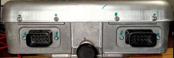

The Tesla GEN2 charger is a single/three phase 10kW AC charger that was fitted in the Model S from 2012 until it was replaced in the 2016 'facelift' model with GEN3.
[[File:Tesla gen2 xray.png|thumb|Tesla Gen2 X-Ray]]
One or two GEN2 chargers are installed beneath the rear seats in the model s for ac charging.
The Tesla GEN2 on-board charger (OBC) is a single/three phase 10kW AC charger that was fitted in the Model S from approx. Oct2013<ref>https://teslamotorsclub.com/tmc/posts/6560948/</ref> until it was replaced in the 2016 'facelift' model with GEN3.  It was the first Tesla OBC capable of fully utilizing external 3-phase AC; [[Tesla Model S GEN1 Charger|previous Tesla OBCs]] lacked the external wiring for three phases.
One or two GEN2 chargers are installed beneath the rear seats in the Model S for AC charging.
The charger is made up of three 3.3 kw modules, each sitting on a liquid cooling plate. This assembly enables both single and multi phase ac charging.
The charger is made up of three 3.3 kw modules, each sitting on a liquid cooling plate. This assembly enables both single and multi phase AC charging.

Charger Dimensions: 500x300x100mm
===Supported Tesla Part Numbers (TPN)===
It has been found that early revision units will not work with the OI control boards.<ref>https://openinverter.org/forum/viewtopic.php?t=932</ref>
TPNs to avoid:
*1014963-05-B and 1014963-05-C
TPNs tested and known good:
*1014963-00-C/E/F/J/K/L
**1014963-00-C <ref>https://openinverter.org/forum/viewtopic.php?p=34710#p34710 and also by Lars on June 25th 2024</ref>
**1014963-00-G is likely also good, just wasn't mentioned by name in the referenced thread

Charger Connections
A1 A2 A3 A4 A5 B1 B2 B3 B4 B5 B6
OUT2 - AC present D1 - enable 12V supply CANH Control Pilot
A6 A7 A8 A9 A10 B7 B8 B9 B10 B11 B12
OUT1 - HV enable D2 - 3p GND CANL Proximity
The outputs will not output 12v, they are low side switches. If you require a 12v ac present signal then use a relay with its coil switched from the relevant pin. wiring diagram
