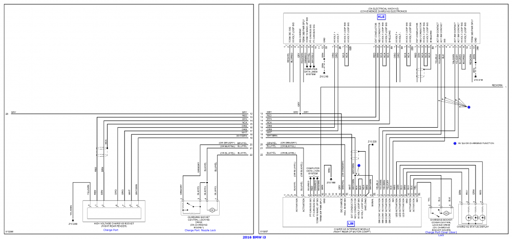

The BMW LIM module is a CCS, CHAdeMO and AC charging controller. It is used to communicate between the vehicle and the public charging infrastructure, to allow fast charging to occur.
As these can be found affordably on eBay and from auto wreckers, they have been pursued as an open-source charger-interface project.
The LIM is also available new from BMW spare parts suppliers for € 240. If you acquire it new, it comes without firmware loaded, and it must be programmed first.

Wiring Diagram
Note [18Jun2022 ALS]: In the above diagram, some details may be non-current, eg the Charge Port Cover sensor is not shown, but its line @ 4B-12 must be floating (signalling that the Charge Port Cover is closed (?)) in order for the LIM to proceed with its welded contact tests; 4B-12 is tied to Ground (?) to indicate that the cover is open[11].
Wiring notes
Make sure you mount the LIM as close to the charge socket as possible and keep the pilot wire separate from the high power wiring.
Bad pilot wiring can result in SLAC, PLC, or other communication problems.

Charge port
SAE J1772 (US) and IEC 61851 (international) cover the general physical, electrical, communication protocol, and performance requirements for the electric vehicle conductive charge system and coupler.
https://en.wikipedia.org/wiki/SAE_J1772#Signaling
The original BMW i3 Type 1 charge port has 2.7 kΩ between PP and PE and no connection between CP and PE, as J1772 describes.
The Type 2 charge port used in Europe probably has 4.7 kΩ between PP and PE. (from Phoenix datasheet. Not confirmed!)
The Type 2 charge port used in Europe has no PP - PE resistor.
Make sure to match these if you want to use a different charge port. Some brands use different resistance values.
The CP communication for US Type 1 (1-phase) and EU Type 2 (3-phase) charge ports is similar, but the PP circuit is different.
Charge port lock
In the BMW i3 a quite expensive Phoenix/Delphi CCS charge port is used, and it would be convenient to be able to use the cheaper Duosida CCS charge ports.
The charge port lock should work with the Duosida lock as well but the feedback (1k unlocked, 11k locked) is a bit different which requires some additional resistors.
