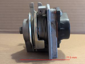

[[File:Side view.jpg|none|thumb|Side view,  P/N 37971-RCA-A01 (Honda Element)]]

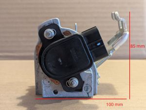

[[File:Side view 2.jpg|none|thumb|Side view 2,  P/N 37971-RCA-A01 (Honda Element)]]

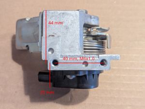

[[File:Rear view.jpg|none|thumb|Rear view,  P/N 37971-RCA-A01 (Honda Element)]]

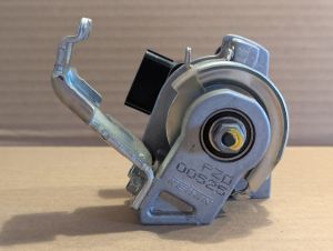

[[File:Underside view.jpg|none|thumb|Underside, P/N 37971-RCA-A01 (Honda Element)]]
[[File:With cover and bracket.jpg|none|thumb|With cover and bracket,  P/N 37971-RCA-A01 (Honda Element)]]
