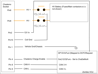

https://www.youtube.com/watch?v=zuPvgzQt6XQ
Requirements
  • Chademo Socket
  • 2 Contactors for Chademo use
  • Zombie VCU
  • Jumper settings for HS CAN3. Solder SJ6, SJ7, SJ8 and SJ9, as per the instructions on the back of the board. Additionally Solder SJ5 and SJ10 for CAN3 Termination.
  • Chademo set to Charge Control interface in the UI
  • An output set to ChaDeMoAl
  • GP12VINFuct set to DCFCRequest in the UI
Chademo Zombieverter connection diagram
