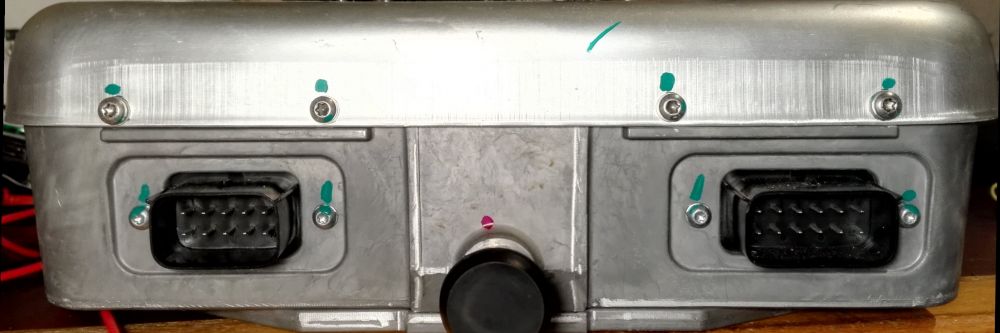

The Tesla GEN2 is a single/three phase 10kW AC charger that was fitted in the Model S from 2012 until it was replaced in the 2016 'facelift' model with GEN3.
One or two GEN2 chargers are installed beneath the rear seats.
Charger Dimensions: 500x300x100mm
Replacement control boards
replacement control board https://github.com/damienmaguire/Tesla-Charger
v5 kit: https://www.evbmw.com/index.php/evbmw-webshop/tesla-boards/tesla-gen-2-charger-logic-board-kit
v5 partially built board: https://www.evbmw.com/index.php/evbmw-webshop/tesla-boards/tesla-gen-2-charger-logic-board-partially-built

Connector part numbers
AC and DC power connections - housing 044441-2006, pins 0433753001
Logic connectors Molex: housing 10 way 19418-0014, 12 way 19418-0026, pins 33012-2001
