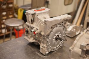

| Picture | Name/link | Manufacturer | Models Found On | Part No/s | FWD/RDW/AWD | Description |
| Toyota/Lexus MGR Rear Transaxle Motor | Toyota/Lexus |
Q211
(2FM - Motor code) |
FWD
AWD RWD |
Found on numerous Toyota and Lexus models (see list to the left), the MGR (or Motor Generator Rear) is an electric rear differential meant to provide occasional 4WD/AWD to the company's larger 4WD models.
For conversion/project purposes the MGR is suitable for lighter models given the torque available or could potentially be used front and/or rear, and/or with a secondary motor. As the motor was designed to be used occasionally as a rear motor, there is a need or potential need for cooling dependent on the application. | |
