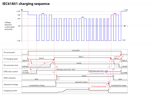

The EVSE (charging station) shares its limits with PWM during IEC 61851/ J1772 AC charging or PLC during DIN 70121 or ISO 15118 CCS sessions, but often the car can not handle the max available power of the charging station.
The actual battery voltage and battery current values are needed by the LIM to check the response of the charging station. In this setup, the battery voltage and current are measured by an Isabellenhütte IVT CAN bus sensor, but these values could also be measured and shared on the CAN bus by the BMS. (CAN message 0x112)

The LIM also handles the (lower level J1772 / IEC61851) communication during AC charging and shares measured PP (charging cable) and CP (charging station) AC current limits in the CAN message 0x3B4 EVSE info.
It is not possible to have two car-side charge controllers connected to the pilot line simultaneously. It is recommended to control the charger by CAN bus. If your charger needs the pilot signal, you will have to emulate it or switch the pilot connection wiring over to the active charger during AC charging.
If the onboard charger accepts an AC current limit, this value can be directly used but some chargers can only be controlled with DC current commands.
Because we don't know the actual AC current, we can only estimate it with a fixed AC voltage and charger efficiency.
DC_current = fixed_AC_voltage * CP_PP_current_limit * phase_count * charger_efficiency / DC_voltage

AC charging
Usually the J1772 (US) or IEC61851 (EU) protocol is used for AC charging.
Some new charging stations support AC charging with ISO 15118 high level protocol as well, but it is not confirmed which versions of the LIM support it.
By default, the the EVSE (charging station) outputs +12V on the CP pin, and when connected to an EV will be reduced to 9V because of a load resistor present in the Electric Vehicle; this signals the EVSE that the connector has been plugged into a EV. After this, the EVSE will send a 1khz +12V to ‐12V square wave (PWM signal) and the duty cycle value corresponding to the maximum current it could deliver. If the EV is okay with that value of current, then it performs a handshake by changing the load resistance and dropping the PWM voltage to 6V, after which the charging begins.
In IEC61851, where untethered charging stations are allowed, the PP pin is used to detect the maximum power rating of the cable.
In the US, with J1772, where charging stations need to be tethered, the PP pin is used to detect if the manual unlocking mechanism is pressed, to stop the current flow before the plug is removed.
More information: https://en.wikipedia.org/wiki/SAE_J1772
