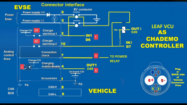

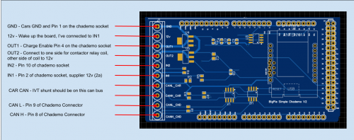

Here's an outline for how I added Chademo to my Beetle conversion, other controllers my differ. The Due and shield board can be substituted with the Leaf VCU from EVBMW
Required Parts
- Arduino Due
- Shield Board (https://oshwlab.com/jamie84.jj/duechademo)
- Isabellenhutte IVT or IVT-S shunt
- 2x contactors
- Chademo port
- Relay
- Firmware
Connections
Wire up the socket as per the diagram below.
