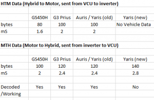

This page is dedicated to use of Toyota inverters (Lexus / Camary / Gen3 Prius / Auris / Yaris) unmodified via the serial protocol (REQ, CLK, HTM, MTH). This page also contains wiring and connector information for the various models of Toyota Inverters.

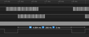

Toyota Protocol
  • REQ Request line from hybrid controller to Inverter
  • CLK Clock signal from hybrid controller to Inverter (Constant 500KHz)
  • HTM Hybrid controller to Inverter data frame
  • MTH Inverter to Hybrid controller data frame
The number of bytes sent/received during a transfer will depend on the model of inverter, the table above outlines the number of bytes for the different inverter models.
Bus Transfer Sequence starts with the REQ line changing state
Toyota Serial example waveforms
Data logging Toyota Serial Protocol
Prius Gen3 PHV (Inverter model G9200-47200) has 105 bytes HTM and 140 bytes MTH

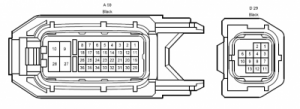

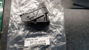

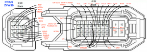

Toyota Inverter Connectors
Lexus GS450 / Camry
Prius Gen3  / Auris / Yaris Connector Body
