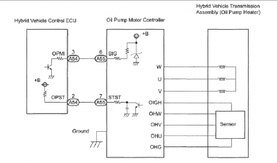

As built, the GS450h supplies oil pressure to the gearbox using either the ICE engine or an electrically-driven external pump. With the input shaft locked in EV applications, the external pump is the only option available. As mentioned previously, this is a vital part of the setup and it's strongly recommended to buy a transmission that still has it fitted. To help with this, here is a reference photo of what to look for.
Wiring and control
The metal case is the ground.
Black (pin 6) is PWM in from your controller.
Brown (pin 7) is feedback from the oil pump. It's PWM. Do what you want with this or leave it disconnected.
The fat blue wire (pin 5) is 12V power. The oil pump uses around 50A Max. So plan for that. Add your own relay to stop it draining your battery while the car is off.
The PWM for this is weird, it's not just 0-100. IIRC it is 0% at both ends, and rises to 100% near the middle, then back down again. This is just based on the sound of the pump with no load, so needs more testing to find the real values.
Here is a list of compatible Toyota part numbers for the oil pump controller: G1167-30020

An option is provided to set the speed in % (0 to 100%) for the electric gearbox oil pump. In this example we set the speed to 50% :
Type v50 followed by enter. A response like this will display:
Configured gearbox oil pump speed: 50
I have found in testing on the E65 that 50% is a good value for keeping oil pressure up , providing cooling etc. without running the pump too hard. Your millage may vary.
