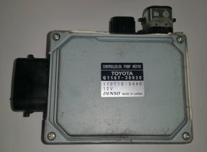

Wiring and control
The external pump also requires a controller. Although this is rarely included with the transmission, it's quite affordably and widely available (Toyota part number: G1167-30020)
Wiring notes:
- The metal case is the ground.
- Black (pin 6) is PWM in from your controller.
- Brown (pin 7) is feedback from the oil pump. It's PWM. Do what you want with this or leave it disconnected.
- The fat blue wire (pin 5) is 12V power. The oil pump uses around 50A Max. So plan for that. Add your own relay to stop it draining your battery while the car is off.
- The PWM for this is weird, it's not just 0-100. IIRC it is 0% at both ends, and rises to 100% near the middle, then back down again. This is just based on the sound of the pump with no load, so needs more testing to find the real values.
