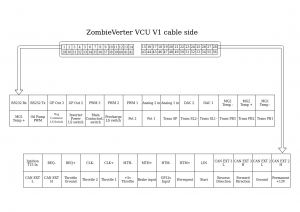

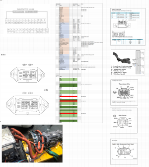

Pin Out Diagram
Further information for a GS450 system can be found here: Lexus GS450h Drivetrain
Note: In the software port 0 = EXT2 and port 1 = EXT
