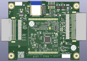

If you scanned the QR code on your gen 3 Leaf adapter board you are in the right place to help set it up!
This adapter board is compatible with Gen 3 Nissan Leaf (model year 2018+) inverters and the open inverter mini main board
This is a work in progress...

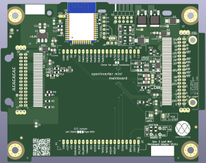

Things to verify
Some of the info was not completely clear for the development of this board. Things that need to be verified:
- Let's use
strikethroughas we verify these items. - The board address needs to be checked with the brake circuit connected and disconnected (cut SJ4 to disconnect, solder to connect it.) Need to verify this does not skew the address voltage and change the address. There are vias to measure the voltage in the board address block to help.
- The second part of the brake circuit looks like it should block 2.5v and below from turning on the brake lights. Above about 2.7v the brake lights should go on. This depends on if the STM32 can push enough power to overcome a few components. Trying to give a wider range of available addresses and still have the brake light output trigger in regen. The high side switch turns on at around 1.2v on the enable line, that's what the zener blocking diode is for.
- R3 and R9 are setup as 0R (jumper) resistors as Nissan had them. These should not be populated for now.
- R2 & R4 are unclear grounds. Need to figure out if these are in fact required grounds.
- J1 connector (Nissan 32 pos.) on position 20 if using thru hole board to wire connectors has only a .3mm trace to ground which likely won't last or work well. If this ground is required there is a large ground via right next to position 20 to solder to for a good ground. Will need to correct this in the next version once understood.
- R13 is a pull down resistor for the T_SINK input. This is at 3K3 in V0.0.1 but unsure if this is ideal. There are 2 plated thru holes on each side of R13 to use to make testing the ideal value easier.
- What connector options to use for the Open Inverter connections to get out of the inverter.
- The capacitors on each contactor mosfet gate should be checked that they do not delay turn on or off too much and that they help eliminate chatter.
There are optional jumpers on both the adapter board and the mini mainboard.
Setting up the mini mainboard jumpers
SJ1 (mini mainboard back) should be **soldered / not soldered.**
This enables a 500 ohm pull-up resistor that is needed for open collector encoders. In the case of the EM57 motor it **is / is not required**.
SJ3 (mini mainboard) soldered to the left is setup for cruise control 12v input. It should stay like this.
Soldered to the right is 3.3v MOSI for SPI communications. Do not apply 12v to this input while shorted to the right of the jumper or damage likely will result. In this case the 3 position solder jumper should be connected middle and the left and should arrive with a small copper trace between the 2.
Setting up the 3rd generation Leaf adapter board jumpers
SJ4 on the Leaf adapter board's lower right side is a shorted solder jumper. It should stay connected.
This jumper allows disconnecting the brake output circuitry from the board address circuitry for testing (see Mini Mainboard Hardware Detection.) **add link** This IO is shared between a board address analog input and a brake light output. Once this is proven out there should be no need to change this jumper.
SJ5 Is an Emergency Stop (E-Stop) input to quickly, non-destructively, and safely shut down the inverter. To use the E-Stop option, cut the SJ5 jumper and feed 12v to **the e-stop input** with a closed when in run position e-stop switch. The switch should break the circuit when the e-stop is pressed or if a wire breaks. Other methods are not recommended for safety, to verify it shuts the inverter down when needed.
To ignore the E-Stop functionality leave the SJ5 jumper alone (closed / shorted.) No need to populate **the e-stop input** connector position in this bypassed case.
SJH1 & SJL1 These should be either both soldered if a CAN termination resistor is desired here or both open only, not one open & one closed. If this is the end of a CAN line these should both be soldered.
There is a capacitor in the middle of the 2x 60 ohm resistors to help filter noise on the CAN lines. There is also a TVS diode (D6) right next to the 40pos. connector to help with static protection.
Soldering on the Nissan connectors
The adapter board is setup with multiple footprints for both of the 32 and 40 position inverter's internal Nissan board to wire connectors.
**Add different connector images**
