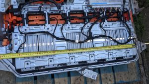

The phase 2 Renault Kangoo 36kWh pack consists of 12 modules, roughly 16kg 14x21x31 cm each in a 2P8S configuration. The usable capacity is apparently 33kWh. It uses a centralised BMS, like the Nissan Leaf, as opposed to a distributed BMS with each module having it's own satellite board. So care must be taken to ensure the cell tap plugs are connected in to the modules in the correct order or the BMS may be damaged. Also note the cell taps will have potentially high voltage across them.

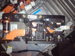

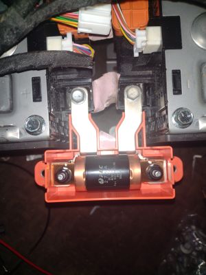

Contactor Box
The pack doesn't have a negative contactor, the only way to isolate it is to pull the service disconnect. In the contactor box there's a current sensor, pre-charge resistor, pre-charge relay, main contactor and a 275a 1000V fuse.
The main contactor is 150a rated.

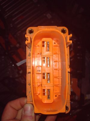

Contactor box | Manual Service Disconnect socket | Mid Pack Fuse |

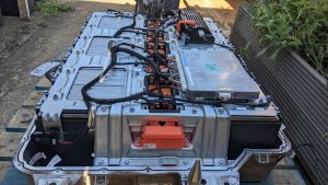

Photos of the wiring below show the correct connection orientation for the BMS and the cell taps to the modules.
