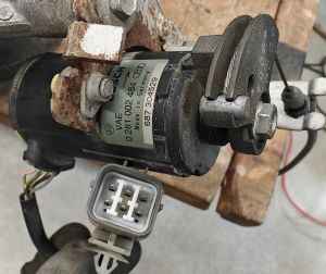

Bosch PWG-3 from a Honda Jazz
The trade name for this sensor is Bosch PWG-3, this is quite ubiquitous and used by several manufacturers over decades

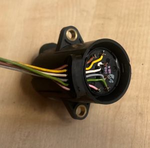

PWG-3 sensor end cap removed, from a BWM 3 E46
When looking for a dual potentiometer sensor, be sure to obtain a SIX-wire sensor. There are variants of this with five wires, they have only ONE potentiometer and a position switch. This list is non-exhaustive, but demonstrates the availability of the sensor
