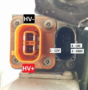

Pinout/Connectors
HV connector: TE 4-2103177-5 (HVA 280 series - key "E")
  • HV+ near to the body,
  • HV- far from the body
LV connector: TE 1-1394416-1
  • Pin 1 is permanent 12V
  • Pin 2 is GND
  • Pin 4 is LIN
  • Pin 5 is HV Interlock loop passthrough (ref. right terminal highlighted with Blue in picture)
  • Pin 7 is HV interlock loop passthrough (ref. left terminal highlighted with Blue in picture)
