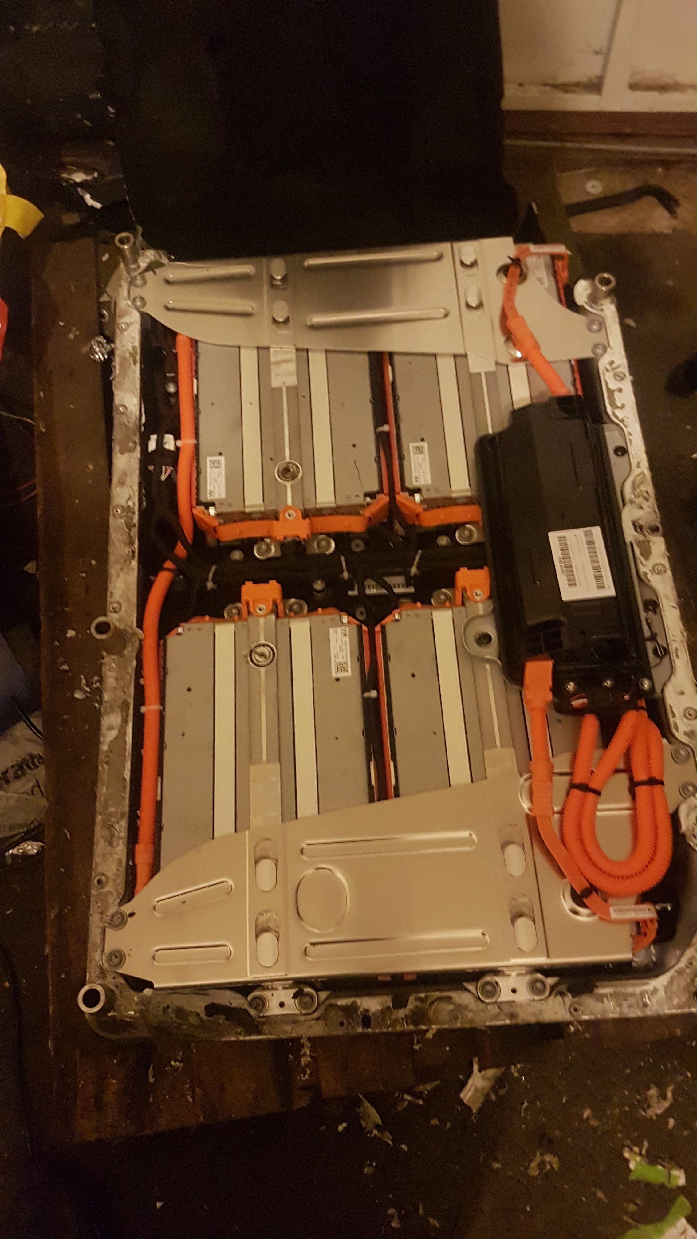

Golf GTE
The same safety advice as above applies, these packs are over 350V DC, this can be LEATHAL. DO NOT BE COMPLACENT.
The Golf GTE pack is a heafty aluminium box with a plastic lid. The lid is covered in a very thin aluminium layer. I found it quite a task to break in, there's a lot of silicone around the perimeter. I used a mixture of breaking the cover and levering it up as much as possible and cutting the silicone.
Under the plastic is a blanket covering the modules. The goodies are underneath. none\thumb
