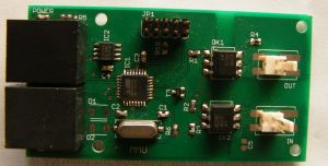

Isolator module
Isolator module

The communication is terminated/translated via an isolator module. It translates the "proprietary" 1-wire protocol to a standard protocol, currently RS485. Its output connects the the first cell-groups positive terminal via a 1k resistor (Pin 3 of the 4-cell module) and the communication input. Its input connects to the last cell groups positive terminal, also via 1k resistor and the communication output.
All communication that goes into the first module is forwarded in a daisy-chain manner out to the last module. Each cell module can see the communication stream of the modules BEFORE it but not the modules after it. Exception: address mode, discussed below.

Isolator Command line interface
As already known from the inverter the isolator is controlled via a simple command line interface to carry out above operations. Since there can be more then 1 isolator on the RS485 bus each isolator is automatically assigned an address that has to be supplied to each command. This results in a hierarchical bus structure where the 1st module on the 1st isolator has address "1.1" and the Nth module on the Mth isolator has address "M.N". Com speed is 115200.

mmuver x
Print firmware version of isolator X (used to be called module management unit)
