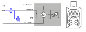

| 1B-4 | LOCK_MOT+ | Charge Inlet Lock Motor |
| 1B-5 | LOCK_MOT- | Charge Inlet Lock Motor |

| 1B-15 | CHARGE_E | Goes to KLE. Guessing this is charge enable or drive interlock signal? |
| 1B-16 | LOCK_FB | Charge Inlet Lock Feedback (1k unlocked, 11k locked) |

Duosida inlet lock feedback
The i3 uses a quite expensive Phoenix CCS inlet and it would be nice to be able to use the cheaper Duosida CCS inlets.
The charge inlet lock should work with the Duosida lock as well but the feedback (1k unlocked, 11k locked) is a bit different which requires some additional resistors.
