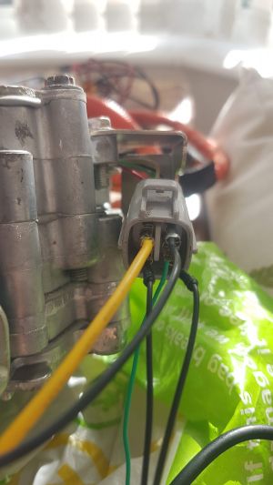

The photo below is a Gen 3 heater and is CAN controlled.
Gen 3 (2016-2019)
Low Voltage Pinout (Gen 3)
Top row, yellow is 12+, black is GND.
Bottom row, under the yellow is Can H and under GND is Can L
The mating connector looks to be Sumitomo 6189-0126 https://www.auto-click.co.uk/6189-0126?search=90980-10942
1 - 12v, 2 - GND, 3 - CAN H, 4 - CAN L
