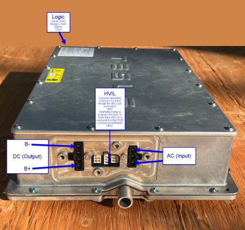

There are six discrete connectors on the GEN1 OBC. In typical applications, they are not all in use.

Input/Output Connectors

The AC Input Connector housing needed to plug into the charger is Molex 42816-0412[9]
Molex 42816-0412 housing, 4P, for AC Input.
The female terminals for this housing are Molex 42815-0134[10] for 8 AWG (8mm²).
Molex 42815-0134 female terminal, for 8AWG (8mm²) wire.
AC (Input) Connector Xnnn
The DC Output Connector housing needed to plug into the charger is Molex 42816-0312[11]
Molex 42816-0312 housing, 3P, for DC Output.
See above DC Output Connector above terminals; it uses the same female terminals.
HVIL Connector Xnnn
  • Only the outside pins are in use. These are used to integrate the HVJB's Lid Reed Switch into the HVIL loop, and this is connected to the HVJB's Lid Reed Switch if the OBC is the only (single) or Master (dual) OBC.

  • For Slave OBC, or all RAV4 EV, this connects to a short loopback harness instead.

Common Issues
  • The Tesla chargers are very sensitive to grounding. The case MUST be connected to vehicle 12v ground and EVSE earth/ground when charging. [1] The OEM installation for the Tesla Model S has a prominent ground strap.
Tesla Model S GEN1 OBC, showing prominent Ground Strap
  • Two 50A fuses protect the AC input legs: for 1-ph version, one fuse for Neutral, one for Hot/L1. These fuses are a common failure point. The cause of their failure is not known. Some units have their fuses fail more than once. There are two, and typically only one fails at a time. The fuses are "semiconductor fuses", special high-speed parts (opposite of "slow-blow") for use with sensitive electronics, and they sometimes have a hybrid diode-and-fuse symbol, though they have no diode function. The OEM fuse is Ferraz Shawmut 50A 500VAC fuse, part No. A50P50-4[12]. Some people have found that after replacing a single failed fuse, the other one will later fail, so the generic recommendation is to replace them both. Typical pricing is USD$50-100 each in 2023.
