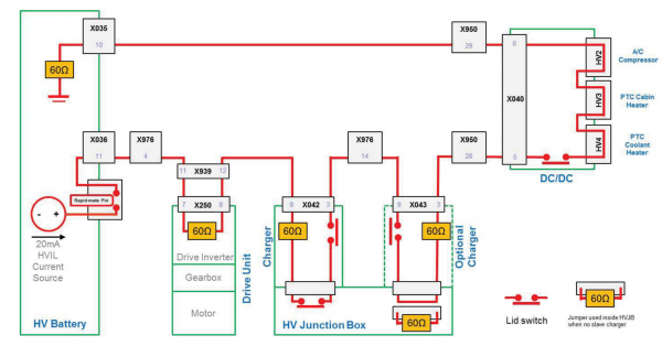

Telsa Model S GEN1 HVIL Schematic (amended).
Telsa Model S GEN1 HVIL Schematic (amended): shows the lid switches explicitly called out, and the "parked" vs "installed" HVIL Loopback on Second/Slave OBC.
HVIL (J5): Only the outside pins (top and bottom) are in use. These are used to integrate the HVJB's Lid Reed Switch into the HVIL loop. Every OBC contains a 60 ohm resistor in series with its Lid Switch, between Logic Connector (X042/X043) pin 3 and HVIL connector "top pin".
  • Tesla: Connected to the HVJB's Lid Reed Switch if the OBC is the only (single) or Master (dual) OBC. If the OBC is configured as Second/Slave, a loopback harness is connected instead.
  • Tesla: The loopback harness, Tesla 1101371-00-A, is included/stored inside all Tesla Model S GEN1 Rear HVJB in an internal "parking" socket, when only a single OBC is provisioned.
  • Toyota: A loopback harness is always connected.
  • MB: TBD (probably a loopback harness is connected).
