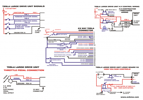

LDU connection diagram

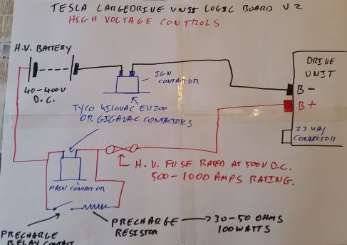

HV wiring with precharge and main contactors
PIN NUMBER OEM OPEN SOURCE
1 IGN +12V IGN +12V
2 BRAKE ON N.O. BRAKE ON
3 BRAKE OFF N.C. PRECHARGE RELAY
4 CAN HIGH CAN HIGH
5 CAN LOW CAN LOW
6 CHG PROXIMITY MAIN CONTACTOR
7 HVIL IN FORWARD
8 HVIL OUT REVERSE
9 ENC +5V ENC +5V
10 ENC A ENC A
11 GND GND
12 ACCEL 1 +5V ACCEL 5V
13 ACCEL 1 ACCEL INPUT
14 ACCEL 2 BRAKE TRANSDUCER
15 ACCEL 1 GND ACCEL GND
16 ENC B ENC B
17 ENC GND ENC GND
18 ENC SHIELD ENC SHIELD
19 CAN HIGH OUT
20 CAN LOW OUT
21 ACCEL 2 +5V CRUISE IN
22 ACCEL 2 GND GND
23 12V ALWAYS T30 START

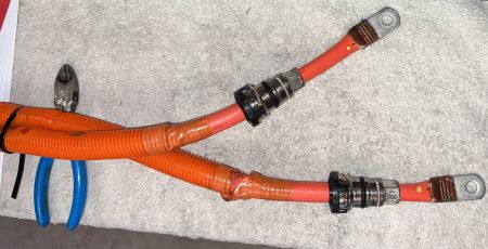

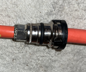

The OEM LDU HV cables' insulation OD is ~.680" (17.3mm) (verified for the "early" Model S units). The HV cables are EMC shielded, and use proprietary EMC cable glands which are not available separately. Fellten supplies custom aftermarket cable glands to fit the LDU's case and aftermarket 70mm2 shielded cabling[1]. The early Model S LDU cables are ~44" (1120mm) in length. One part No. for the cables set is 1004872-00-B.
Tesla Model S LDU HV Cables' proprietary gland connector.
The OD of the casting where the external o-ring is located is ~1.030" (26.2mm). The OEM gland nuts are plated and are often found in a corroded state.

Supply inverter with some high voltage. For first tests it is recommended to put a large resistor/heating element/kettle in series.

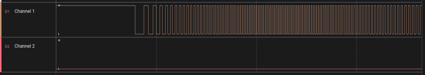

Here is a picture of what it may look like when one encoder signal is missing:
Note how Channel 1 shows an encoder signal but Channel 2 looks completely flat. This should not occur. If one is showing a signal, so should the other.
