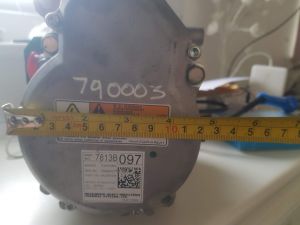

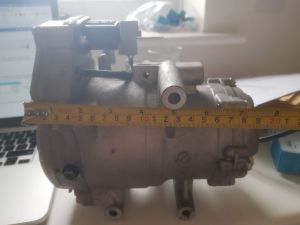

Weight 6.2kg
Length 19cm
Height 20cm
Width 12cm
3D scans are here: https://grabcad.com/library/outlander-phev-ac-compressor-1 this appears to be of an older model than the one in the photos below. The photos are from a 2018 model year vehicle.
Height
Height
Length
Length
Width
Width
