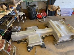

Dismantling
!!! SAFETY WARNING !!!
The contactor/precharge circuit has a charged capacitor bank inside the battery pack. This must be bled manually using external resistor at disassembly.
Proceed with cation during pack disassembly!

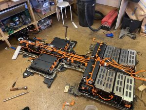

2020 e-Golf battery pack with protective cover removed.
There are just a few screws and nuts holding the cover in place. Then pry around the edge all around too remove the glue holding it in place. There are several videos on Youtube walking through the process.
Wiring
The modules are connected with busbars. These are probably of least interest as these might be hard to reuse later given their unique shapes.
In the pack you'll find two main cables harnesses, one orange and one black.
  • Black = 12V cabling, U30, Ignition, CAN H, CAN L etc. Connects all master modules
  • Orange = Balancing leads between slaves and masters + temperature leads of the slaves
The orange cabling is actually 8 separate harnesses. First thing is to unwrap most of the orange tape to find the 8 separate smaller harnesses.
Each harness has:
- One black connector = Temperature leads to the master
- One red connector = Balancing leads to master
- Two, three or four blue connectors = Balancing leads and temperature leads from slaves. More on this later...
Note that the orange harnesses is all different and must be matched with the correct master module. More on that later.

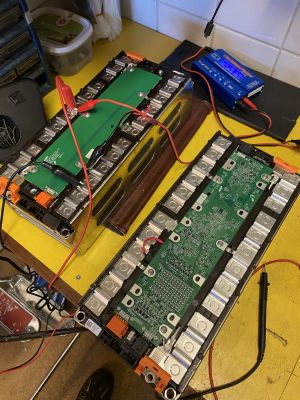

Module configuration
Master and slave module without protective top cover on
Every master modules is uniquely configured for a set of either full of half slave connections.
"2" means half-slave 2S3P
"4" means fill-slave 4S3P
  • CMC1 = 2 + 2 + 2 + 2
  • CMC2 = 4 + 2 + 2
  • CMC3 = 2 + 2
  • CMC4 = 4 + 2
  • CMC5 = 4 + 4
  • CMC6 = 4 + 4
  • CMC7 = 4 + 4
  • CMC8 = 4 + 2
Note: CMC 5/6/7 and CMC 4/8 share the same configuration, therefore, the orange cable harness is interchangeable between those.

Connecting to the master modules on CAN
In order to make the master modules behave "nicely" and send and respond on CAN as expected, they need all prerequisites fulfilled:
  • The right orange cable to the right amount of slaves and the right type of slave (as per above).
  • All brown wires from the black connector to GND
  • All green and red, green and yellow wires from the black connector to +12V (TO BE CONFIRMED)
  • Master (+) terminal connected to Slave 1 (-)
  • Slave 1 (+) connected to Slave 2 (-) and so on...
The cell temperature and balancing status is reported continuously.
The cell voltages are only transmitted as response to a message:
