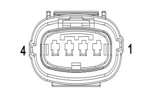

Low Voltage/Control
Unidentified - see image
Pinout
MG PTC Connector Pinout
Pin Cross Section Colour Function
2 0.35 Green/White +
3 0.35 Pink/Black LIN
4 0.35 Black GND
MG PTC Connector
MG PTC Connector
