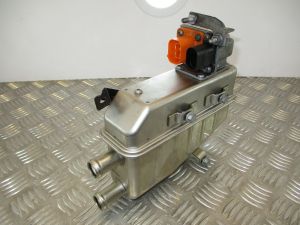

Volkswagen Heater
General Information [1]
- Operating Voltage: 280VDC - 450VDC
- Power: 5kW (7kW "boost" between 350-450V)
- Control via LIN by integrated electronics
- Temperature control by integrated sensor
- 3d Scan: https://grabcad.com/
Dimensions
- Fluid connection (mm): 20 (Nozzle dimensions according to DIN3021-3[2])
- Dimensions L x W x H (mm): 210 x 73 x175
- Weight (kg): ~1,7

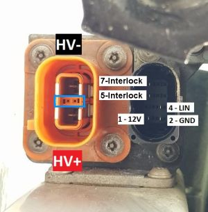

Pinout/Connectors
HV connector: TE 4-2103177-5 (HVA 280 series - key "E")
- HV+ near to the body,
- HV- far from the body
LV connector: TE 1-1394416-1
- Pin 1 is permanent 12V
- Pin 2 is GND
- Pin 4 is LIN
- Pin 5 is HV Interlock loop passthrough (ref. right terminal highlighted with Blue in picture)
- Pin 7 is HV interlock loop passthrough (ref. left terminal highlighted with Blue in picture)
