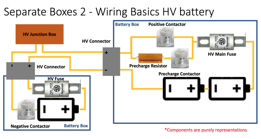

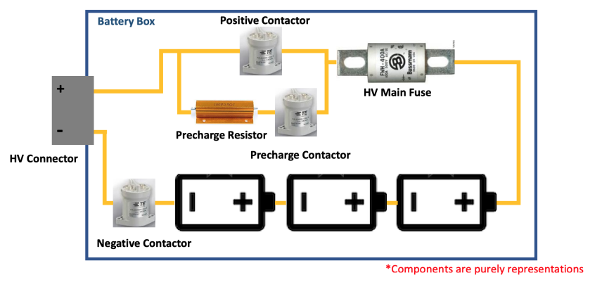

  • Be aware, certain BMS architectures use cell taps to measure each cell voltages, these will have high voltage between higher cells
Battery Box – A structure that houses the batteries and other HV related components. Can be made up of sub assemblies, when mentioned here it refers to the assemblies as they will be installed into the vehicle.
Design Requirements
  • A fuse is fitted to every battery box, this is there to protect the HV cables running out of the box.
  • A BMS should be used to monitor cell voltages and temperatures to ensure they remain within safe operating limits.
  • A battery box should never have two live cables coming out when being installed;
    • HV Contactor inside the battery box which disconnects one end of the battery
    • Service disconnect which can be removed and installed with the pack in place on the vehicle
Single Battery Box Example
2 Separate Battery Boxes Example
