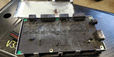

Seems that i need one of thease too
this was renault Influenza bms. Battery module connectors were same, but they are not wired all same. Big bang and smoke when switched main switch on..
