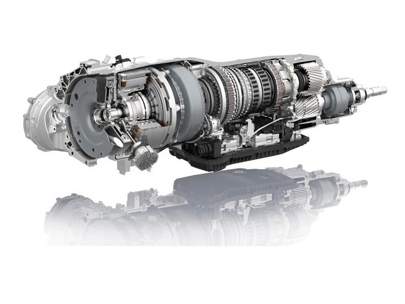

This is the gearbox:

The Q7 has a permanently excited synchronous motor according to the service bulletin
