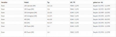

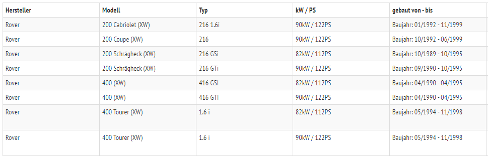

Sachs definitely has clutches with 20x22-20N pattern: https://www.atp-autoteile.at/de/product ... ngsscheibe
Try calling Sachs or Sachs Performance directly. Maybe they can give you the center part of a clutch since that's all you need to fabricate the adaptor.
Zapatero
Posts: 445
Location: Germany, Ulm
Has thanked: 25 times
Been thanked: 42 times
Re: Toyota GT86 with Nissan Leaf Motor
Post by Zapatero »
crasbe wrote: Wed Oct 30, 2019 11:30 am Sachs definitely has clutches with 20x22-20N pattern: https://www.atp-autoteile.at/de/product ... ngsscheibe
I ordered the Clutch - if you're right that is a GREAT find!!!!!! :!:

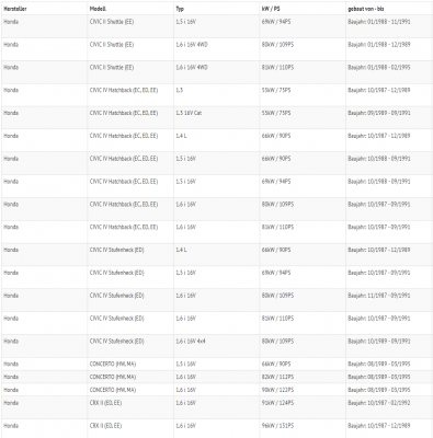

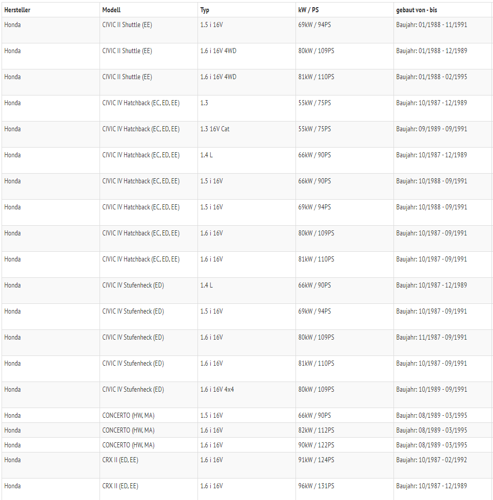

Are you 100% sure that 20x22-20N are the correct spline dimensions ? I've searched but can't find any specs.
It would be brilliant if this clutch centre fits properly !
let us know ! ;)
zippy500
Posts: 220
Location: United Kingdom
Has thanked: 76 times
Post by zippy500 »
Google is referencing this clutch plate to a 1988 onwards Honda Civic-
Is anyone one getting this answer ?
crasbe
Posts: 296
Location: Germany
Has thanked: 47 times
Been thanked: 150 times
Post by crasbe »
zippy500 wrote: Wed Oct 30, 2019 3:18 pm Google is referencing this clutch plate to a 1988 onwards Honda Civic-
That's what the linked page says as well. I attached screenshots of the compatible cars.

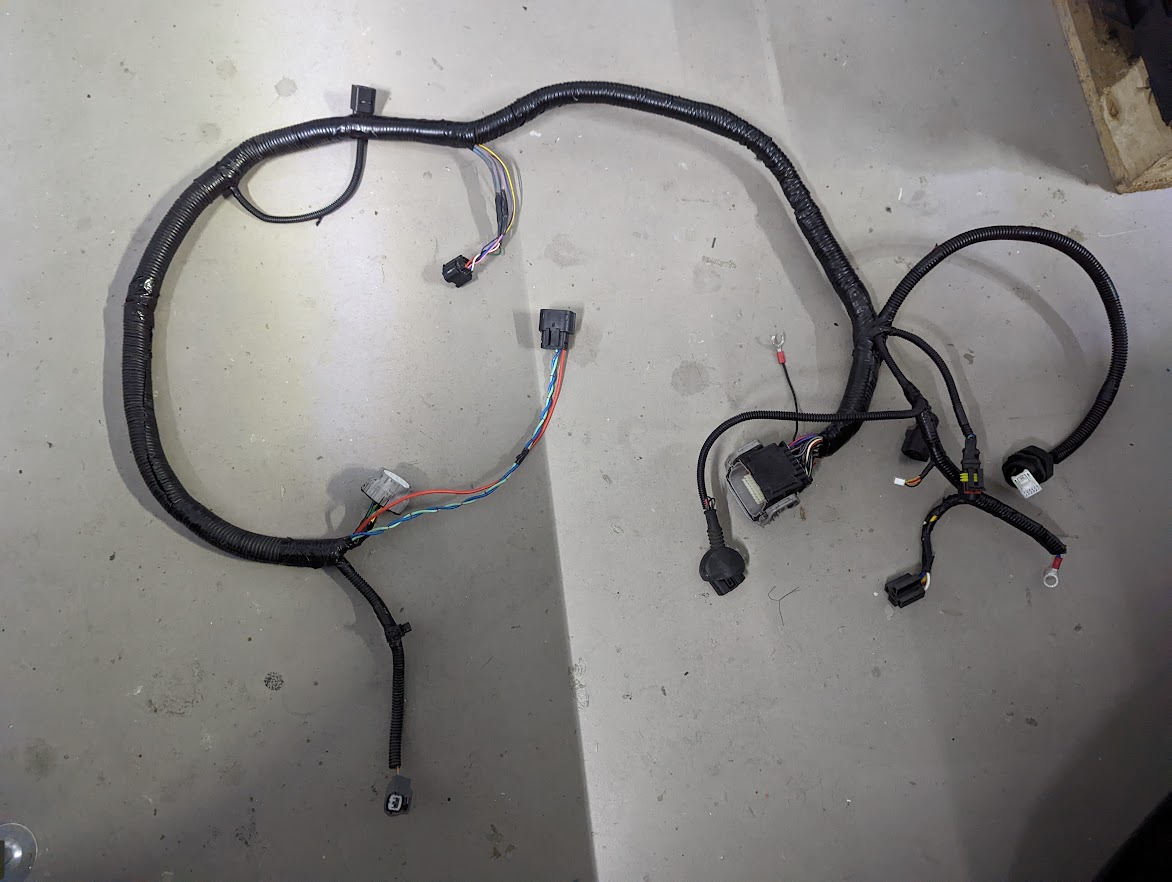

Zapatero
Posts: 445
Post by Zapatero »
The Board is finished and i'll drop it in tomorrow.
Then i'm going to connect the Inverter to the Car to see how unhappy the car is with the situation of the missing Engine...
