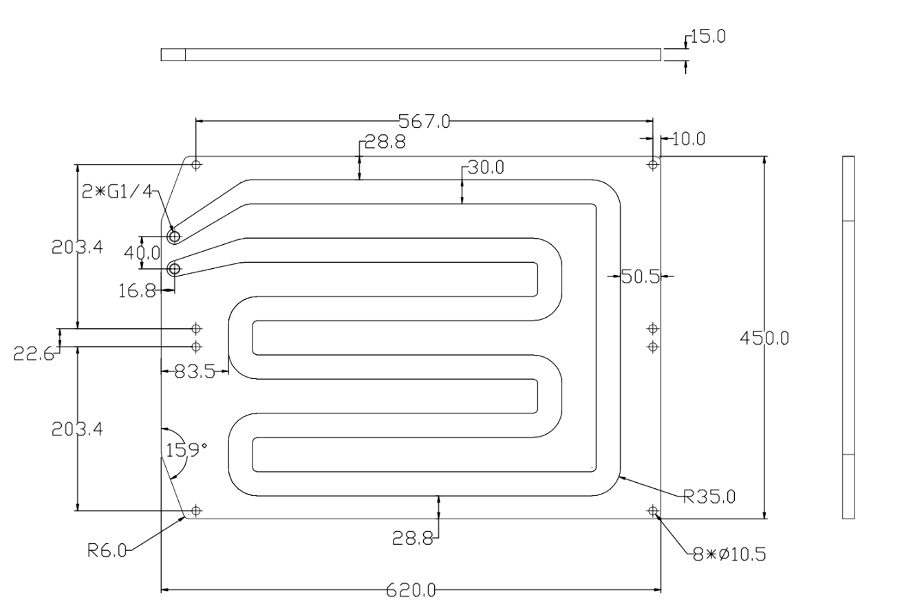

I now have the finalized STP file for the cooling plates - and of course open source as always:

Re: Tesla Roadster Battery replacement with ID.3 Modules
I have some news on the cooling plates. Looks good i think

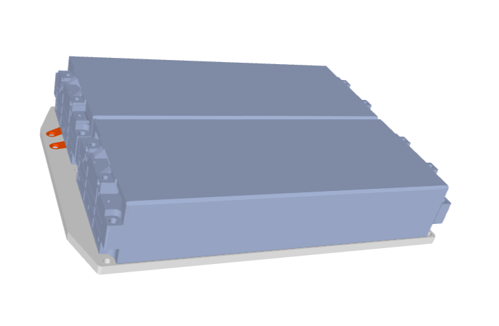

According to my measurements 8 ID.3 modules in a 2 × 4 stack would be about 59 × 46 × 48 cm and should fit into the box that has available room without the weird shaped lower part of 95 × 48 × 48 cm
This is the Conversion with Taycan Modules:
There is the ...
There is the ...

There is already a running conversion out there with taycan packs and according to my measurements the ID3 modules will fit nicely
We'll see
