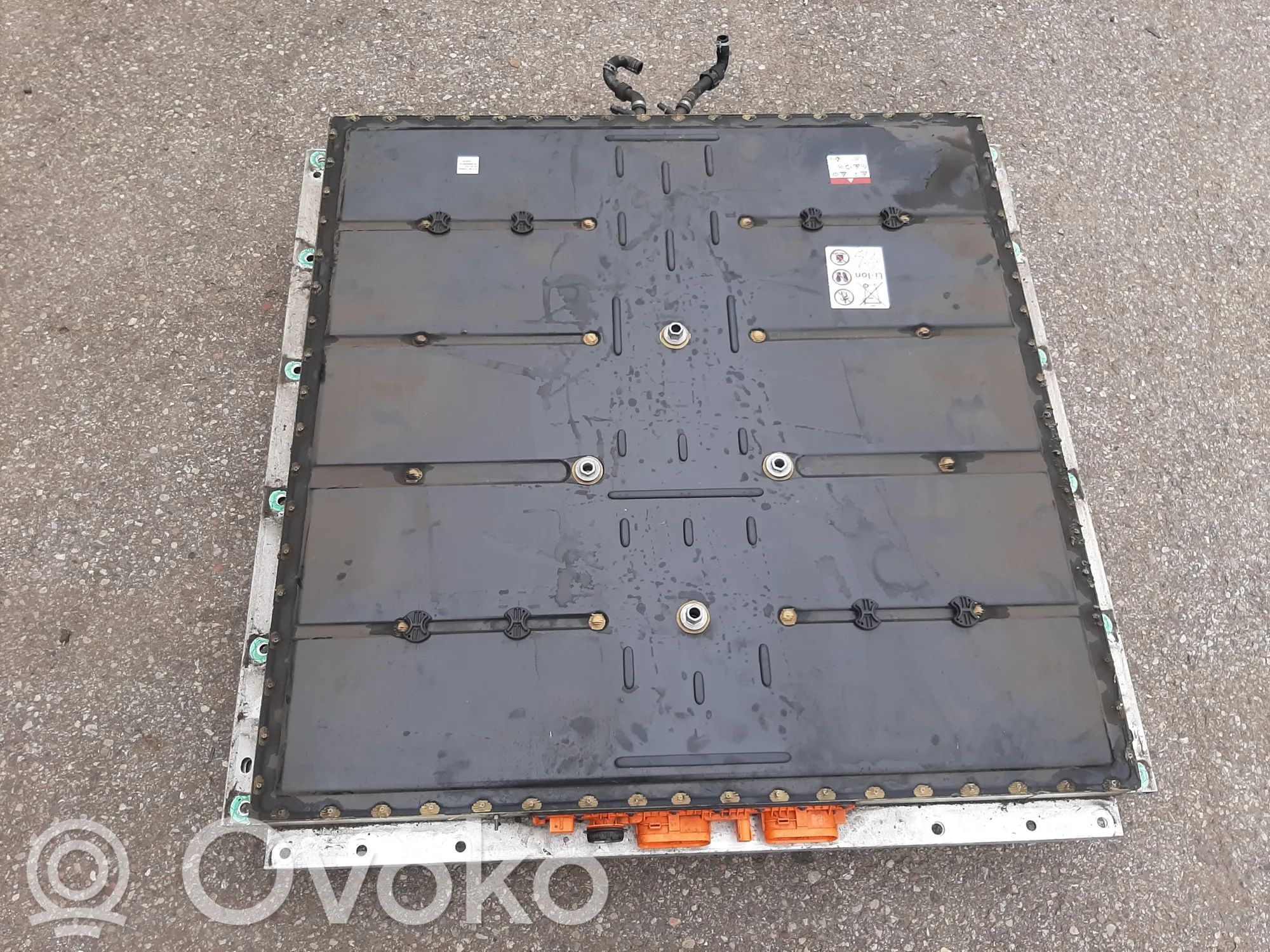

So I purchased a VW ID.3 battery from a 2024 model year with about 15,000 km. With the help of Johannes and his BMS, I am going to build a new battery pack for the Tesla Roadster. I will use 8 of the 9 VW ID.3 modules. Since the 62 kWh MEB modules are 12s2p, that gives me a 96s pack. The original Roadster pack has 99 monitored brick voltages, so the conversion will handle the 96s-to-99-brick by "faking" the 3 Cells on the CAN Bus.
The goal is to make the conversion open source so it can help other Roadster owners keep these cars on the road without having to rely on an OEM-style replacement path that is very expensive. Tesla’s Roadster 3.0 battery upgrade is around $40.000 USD as far as i know!
The pack will be liquid-cooled as the original Roadster pack and also have CCS charging capability, based on all the developements that this community has made so far.

According to my measurements 8 ID.3 modules in a 2 × 4 stack would be about 59 × 46 × 48 cm and should fit into the box that has available room without the weird shaped lower part of 95 × 48 × 48 cm

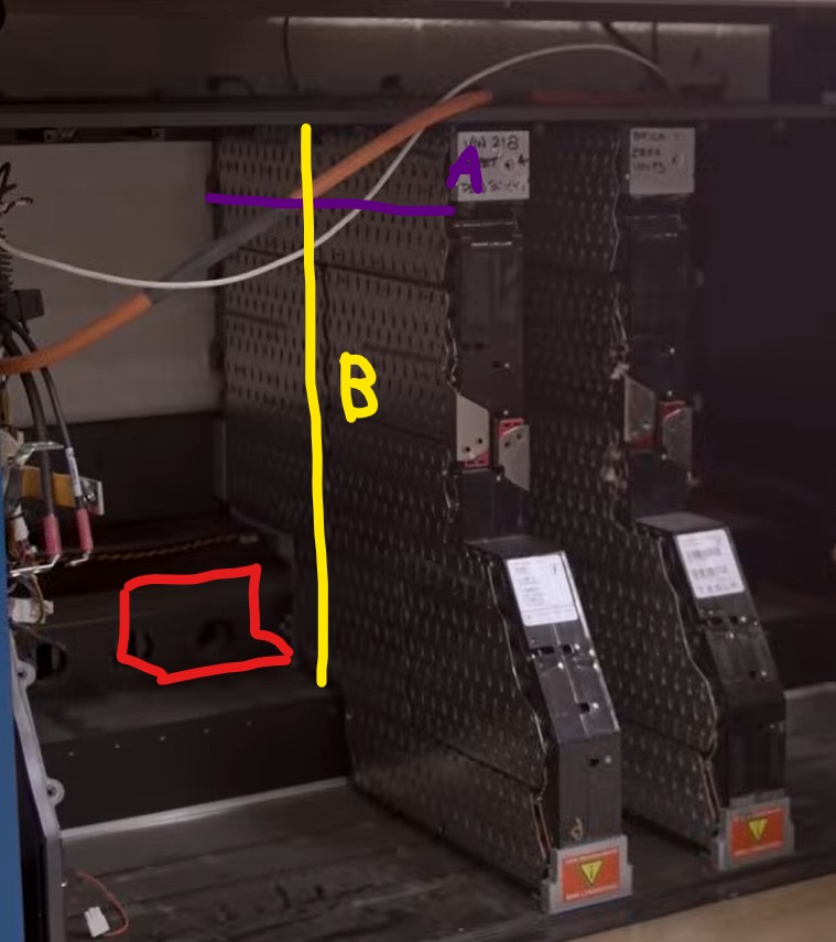

Post by Zapatero »

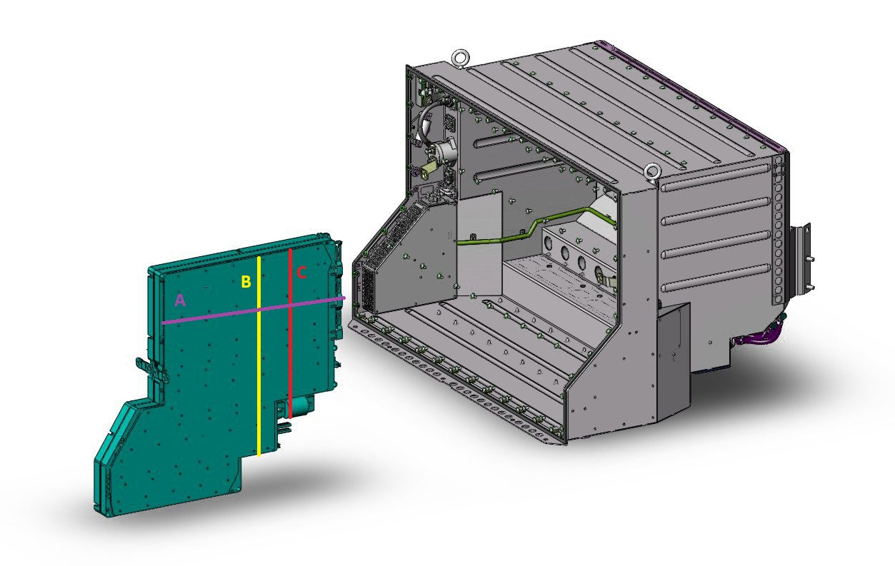

I asked Gruber Motors (They are incredibly helpful! Tesla Roadster specialist in Arizona: https://grubermotors.com/) if they could provide me with the internal measurements of the battery box.
They came back with the following:
A = 53 cm
B = 53 cm
C = 45 cm
Based on that, I did some calculations for an ID.3 MEB module setup:
Configuration:
2 modules in parallel (side by side)
4 layers stacked
= 8 modules total
This results in the following dimensions (without cooling plates):
Height: ~44.0 cm (assuming ~110 mm per module × 4)
Length: ~53.66 cm
Width: ~53.66 cm
There are readily available MEB cooling plates, but buying 8 of those would have been close to €1500.
https://esdi-shop.de/products/batterie- ... 5432523017
Instead I ordered 4 custom cooling plates from Alibaba.
I paid €680 for 4 custom plates, each designed to hold 2 modules per layer.
Each cooling plate is 12 mm thick.
With cooling plates included, the total stack height becomes:
Height: ~48.8 cm
(4 × (110 mm module + 12 mm plate))
Conclusion:
This confirms that the ID.3 modules are a really nice fit for the Roadster battery box — but i will have to modify the box slightly where the original 11 cooling pipes exited the box. See red marked area, of course over the whole width of the box.

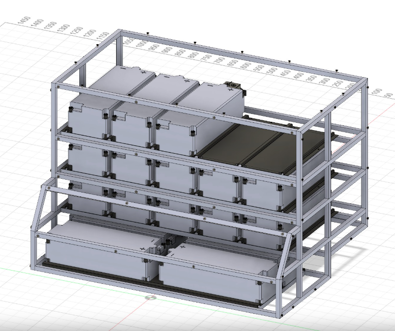

Posts: 2962
Has thanked: 328 times
Been thanked: 847 times
Re: Tesla Roadster Battery replacement with ID.3 Modules
I would scan or CAD up the OEM box and design a new box that has built in mounts for the ID3 batteries and other bits.
Could be easier then modifying the OEM box and components.

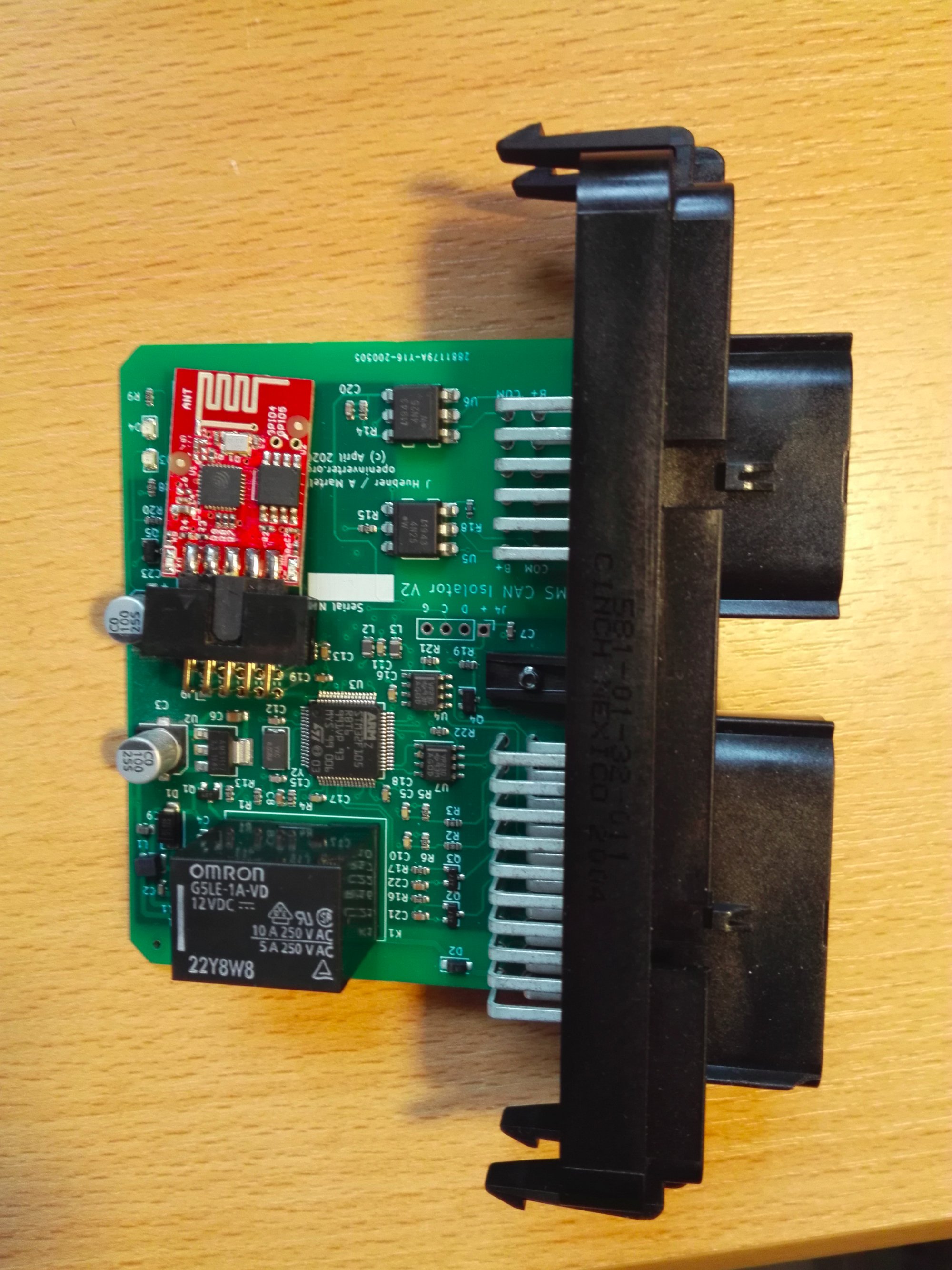

Here on the logic side I will revive the old CAN Isolator that was meant for the BMS. It has 2 CAN buses, a relay and two OC outputs.
It'll run a remix of stm32-car which includes SimpBMS derived MEB BMS code.
Of course no Olimex module but ESP32 CAN for this and Foccci

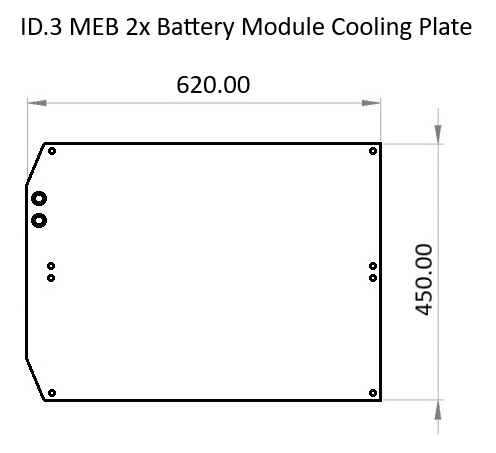

I have some news on the cooling plates. Looks good i think :D

How will they be made?
Who came up with the hole spacing as it looks strange at 203.4mm for the pitch.
Posts: 1155
Has thanked: 246 times
Been thanked: 469 times
why a series loop on the coolant plate? why not in parallel. yeah some strange numbers a tom said, is that based on mounting holes in the original battery enclosure? strange they are not whole numbers
Post by Zapatero »
To be honest, i can't verify the numbers. I sent them a CAD drawing (*.step) of the module that they sent me the recent drawings of the cooling plate.
I know Johannes has a spare module from his build. So i asked him to use a measuring tape and double check the measurements for me. Let's see what he says, if he is able to measure his module for me.

Zapatero wrote: Tue Mar 31, 2026 6:31 pm To be honest, i can't verify the numbers. I sent them a CAD drawing (*.step) of the module that they sent me the recent drawings of the cooling plate.
Those measurements match the CAD file I have for the ID3 modules and I know that model is right, so the numbers look good.
