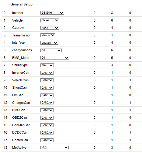

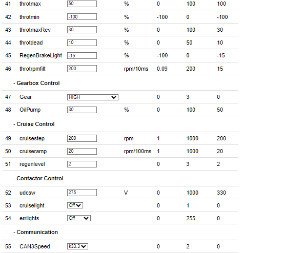

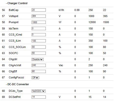

- Tue Aug 12, 2025 12:05 am
- Forum: Projects
- Topic: [DRIVING] 1974 Ford Capri + GS450H
- Replies: 67
Re: WIP 1974 Ford Capri + GS450H
Hi. Got the low speed judder sorted out. I was going the wrong way with some parameters.
Only way to get it to charge is to put it in run mode and plug in the charger.
Screen grabs of parameters

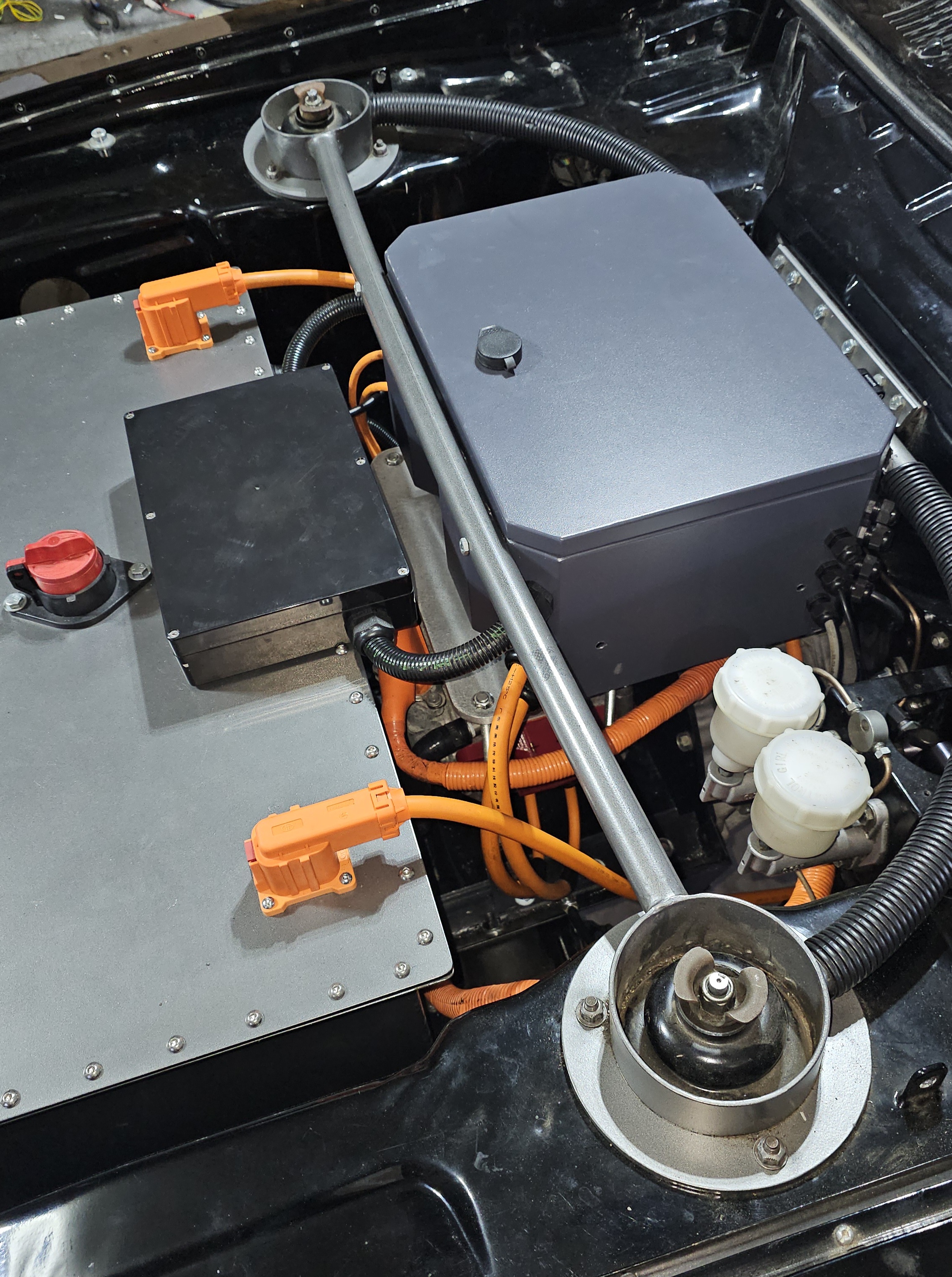

- Fri Jul 04, 2025 6:27 pm
- Forum: Projects
- Replies: 67
Some progress
Pretty much all the physical items in place, final wire up in progress.

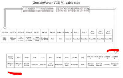

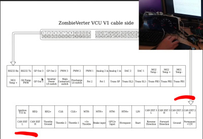

- Sat Jun 07, 2025 3:13 pm
- Forum: Toyota/Lexus
- Topic: 450H inverter polarity
- Replies: 1
Hi. Quick question on the inverter.
Is the HV polarity the same orientation between RHD and LHD inverters, ie, positive always on the left, negative on the right?
This pic from the wiki looks like the RHD unit
Mines from a LHD, has the HV connectors on the ...
