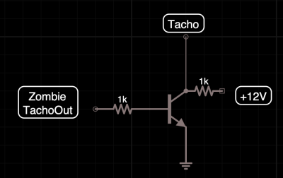

Re: Digital Tacho signal
If I was wiring up a after market ECU id be bypassing the 36.5k resistor and seeing what happens then
It's working ! Thank you.
Now, what kind of circuitry would it take to convert the same TachoOut PWM signal into a signal (Si) suitable for the Speedometer?
Originally, the signal for the ...
find the tacho signal wire into the tacho, 95% of the time it will go through a 10-20k Ohm resistor first thing, I bypass that and also if needed add a 1-10k resistor pull up to 12v so the aftermarket ECU can drive it like I would like.
Please see the diagram of the igniter signal rectification ...

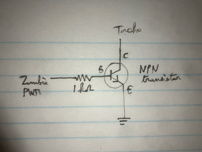

- Wed Sep 24, 2025 7:08 pm
- Forum: User Interface
- Topic: Digital Tacho signal
- Replies: 24
Something like that?muehlpower wrote: ↑Wed Sep 24, 2025 7:39 am Connect the collector to the input of the tachometer, the emitter to GND, and the base with 1k ohm to the output of the Zombi.
I am using Zombieverter firmware 2.30A driving a GS450h setup on a “Classic” car :
Tested with a cheap PWM generator, my digital tachometer is working with a minimum of 11V (average), 50% duty cycle PWM signal (10 to 375Hz full gauge range).
I am trying to use the TachoOut signal on ...
