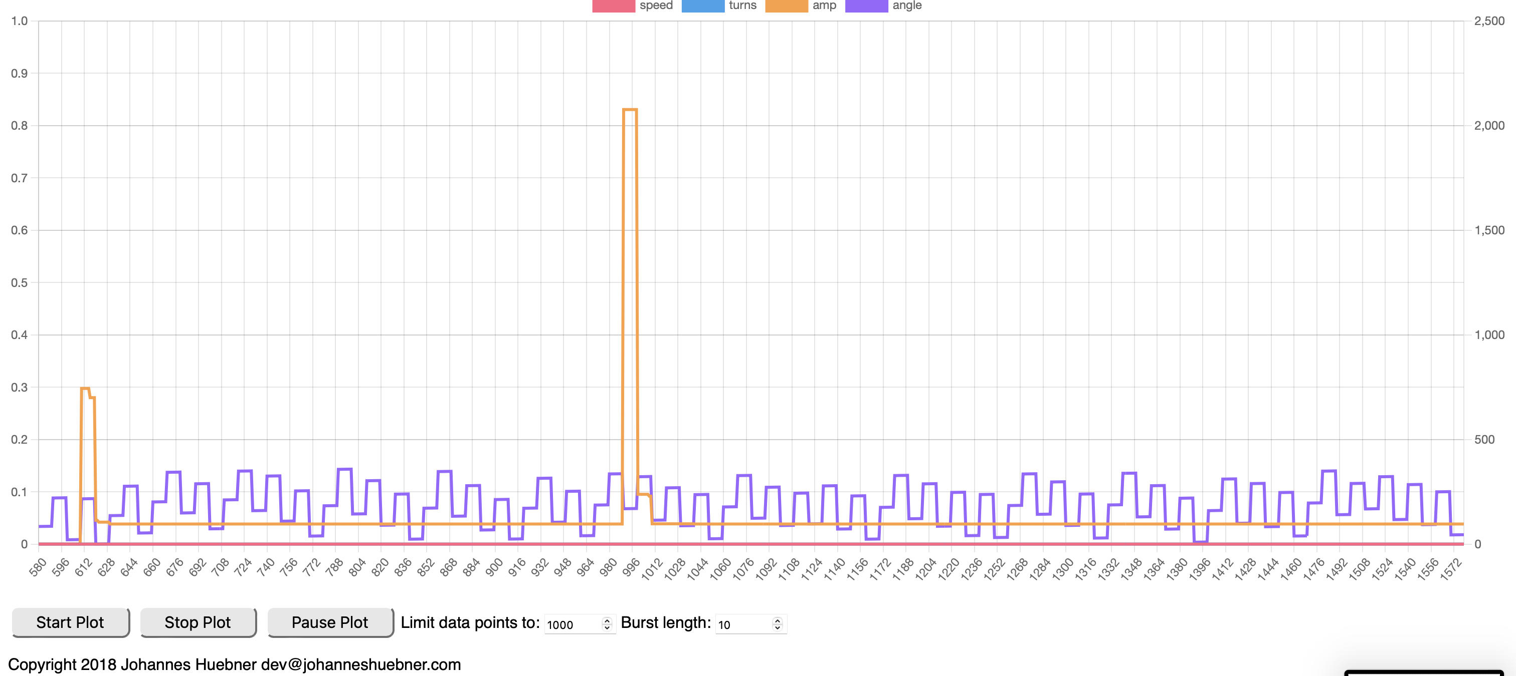

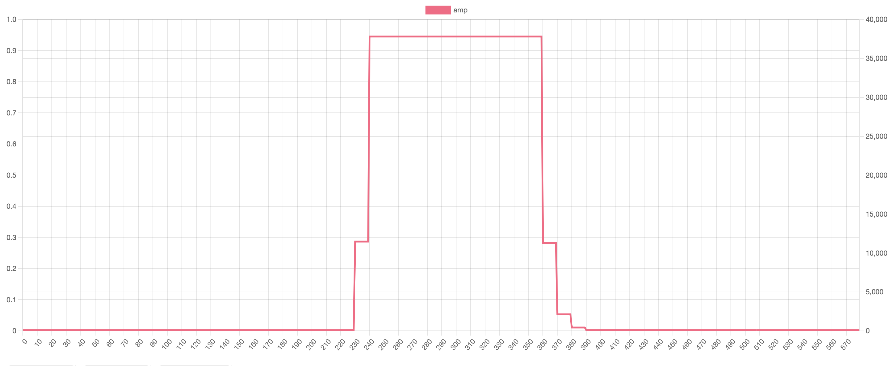

UPDATE: I hooked up the pedal(e46) and plugged in the encoder wires. As soon as I give my direction signal, with no input from the pedal applied, the motor starts spinning. However, it spins very slowly with a rhythmic knocking sound. Depressing the pedal does nothing. The posts on my two 12v batteries start smoking, and I can see one of my cables supplying 25v into my HV box jump. Here is an amp plot.

Error codes are shown in the spot values section, below the parameters.
The jerky/rhythmic motion sounds like a reversed encoder (a common LDU problem, it seems Tesla swapped the pinout at some point), but could also be a setting issue.
The start up without any pedal input sounds like it has idle enabled. Can you download and share your parameter file?
(also, in case you haven't yet, peruse the parameter descriptions here: https://openinverter.org/wiki/Parameters )

That sounds like a wrong wired encoder. Have you tried swapping the A and B signals?

I was able to produce an OVERCURRENT error by flipping the sign on "ocurlim" so I'm confident that OVERCURRENT is not the issue. However I flipped A and B on the encoder side and it had no effect on my issue. I may be missing an encoder signal as from what I understand that can present itself similarly to swapped encoder wires but I don't have the correct tools to test for that, nor do I understand how to remedy that issue.Error codes are shown in the spot values section, below the parameters.
I will absolutely do this once I am able to set up my motor again today. I will upload my parameters as well as compare mine with other people's functioning parameters.Can you download and share your parameter file?
Either way, encoder issues don't explain why my inverter opens my main contactor when I start in manual mode, even with the setting "DcSwOn" set.

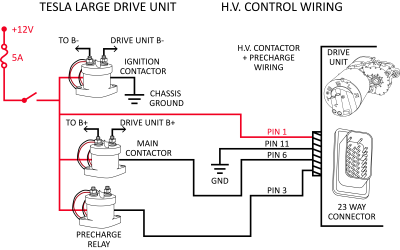

That is an odd issue. Can you confirm how you have your contactors wired (photo and/or diagram)?

The wiring diagram I used is also attached. It's from Damien's GitHub. I realized the issue when starting in manual mode is not one of my contactors opening, it's the main contactor failing to close. The clicking I mistook for a contactor opening was my precharge relay opening. This is probably due to either me not performing a manual precharge, or from udcsw being 12. I'm scared to lower this value to 0 due to user catphish's warnings throughout the forum.contactors wired (photo and/or diagram)?

- Really go through your wiring again and make sure that everything matches the diagram. Note: This may be obvious or sound stupid, but it was something I screwed up the first time by misreading the diagram: the LDU does not supply the 12V positive to either HV contactor. The LDU controls the 12V ground side; your ignition key provides the 12V+ to each contactor and to pin 1 of the LDU
- test your contactors (disconnected from the drive unit) and make sure you can hear each one cycle when you apply 12V. I had a contactor fail shortly after install for no good reason. I had bought 3 identical ones, and one was bad.
- make sure that all of your 12V grounds are connected. Tesla parts seem to be overly sensitive to grounding. I don't know of this being an LDU issue, but its worth checking.
