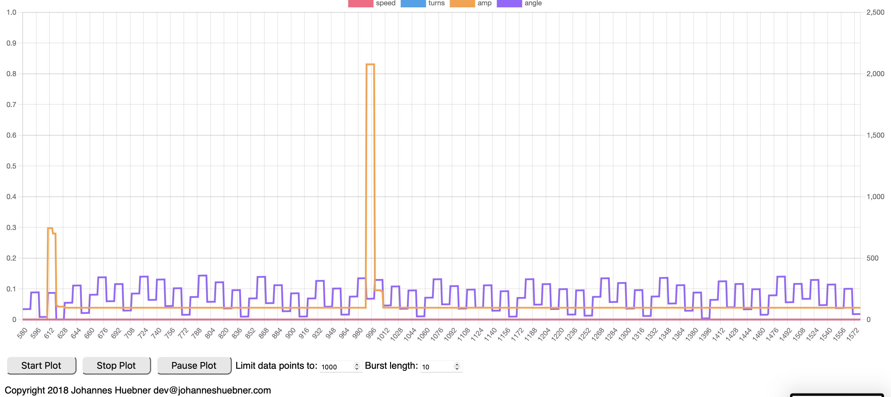

Here is a plot of what I am describing.

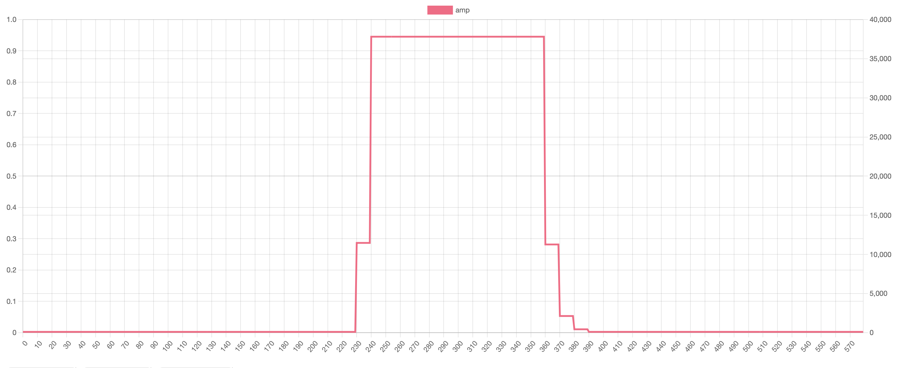

UPDATE: I hooked up the pedal(e46) and plugged in the encoder wires. As soon as I give my direction signal, with no input from the pedal applied, the motor starts spinning. However, it spins very slowly with a rhythmic knocking sound. Depressing the pedal does nothing. The posts on my two 12v batteries start smoking, and I can see one of my cables supplying 25v into my HV box jump. Here is an amp plot.

Error codes are shown in the spot values section, below the parameters.
The jerky/rhythmic motion sounds like a reversed encoder (a common LDU problem, it seems Tesla swapped the pinout at some point), but could also be a setting issue.
The start up without any pedal input sounds like it has idle enabled. Can you download and share your parameter file?

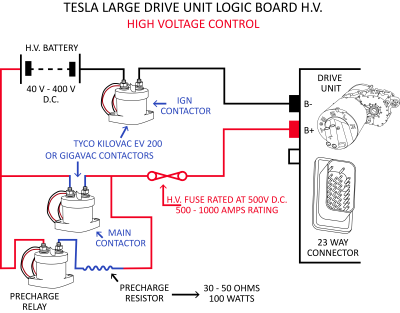

That is an odd issue. Can you confirm how you have your contactors wired (photo and/or diagram)?

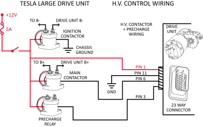

The wiring diagram I used is also attached. It's from Damien's GitHub. I realized the issue when starting in manual mode is not one of my contactors opening, it's the main contactor failing to close. The clicking I mistook for a contactor opening was my precharge relay opening. This is probably due to either me not performing a manual precharge, or from udcsw being 12. I'm scared to lower this value to 0 due to user catphish's warnings throughout the forum.

From those parameters and based on your description above, things should be working properly. If the inverter is seeing 24V, you should not need to lower udcsw below 12V.
We're reaching the limit of my experience, because out of either hubris or stupidity, I never bench tested my setup, I went straight for pack voltage.
HOWEVER, I did have some contactor and precharge struggles, so here are a few things to check:
  • Really go through your wiring again and make sure that everything matches the diagram. Note: This may be obvious or sound stupid, but it was something I screwed up the first time by misreading the diagram: the LDU does not supply the 12V positive to either HV contactor. The LDU controls the 12V ground side; your ignition key provides the 12V+ to each contactor and to pin 1 of the LDU
  • test your contactors (disconnected from the drive unit) and make sure you can hear each one cycle when you apply 12V. I had a contactor fail shortly after install for no good reason. I had bought 3 identical ones, and one was bad.
  • make sure that all of your 12V grounds are connected. Tesla parts seem to be overly sensitive to grounding. I don't know of this being an LDU issue, but its worth checking.
