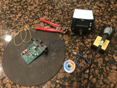

attempted a little silliness today to see if we could pipe out the data to the Nextion display actually using a couple non implemented connector pins
a little hack-a-thon on pins #9 and #10 of the A Connector
- Gregski
- Posts: 2685
- Has thanked: 493 times
- Been thanked: 909 times
then it was time to link the RX / TX pins from the WiFi UEXT 10 pin connector to those on the A Connector
and we can still plug in the little red rascal if we want to
