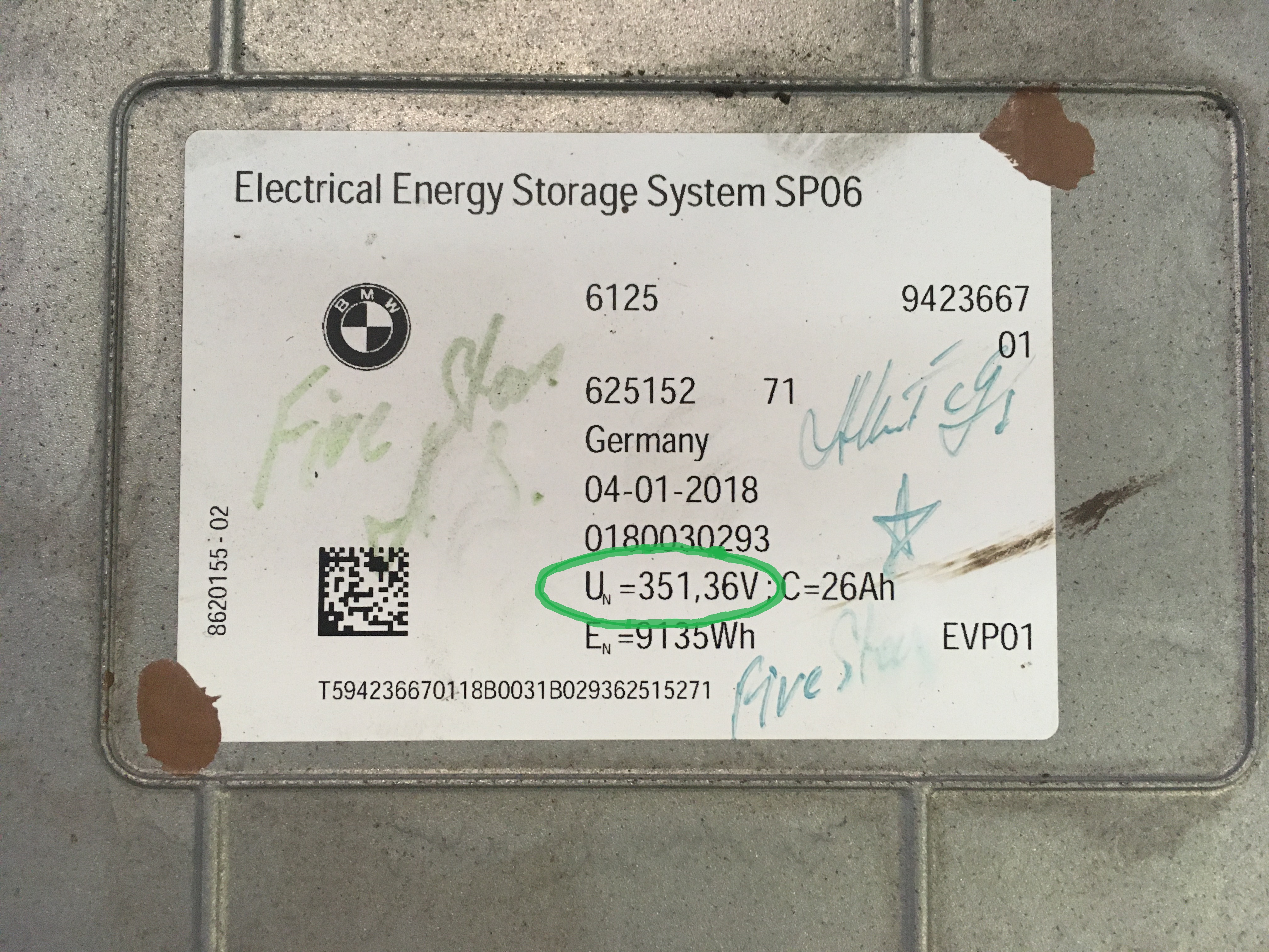

Alright, I've waited forever to do this so today we are going to do some unofficial RANGE TESTS, meaning I still have not fully charged this 9.1 kW (killer whale) battery pack to 100% capacity which the specs claim to be 398 vultures, maybe some day I will comprehend how to charge a 351 volt battery back to 398 volts, to me it's like pouring 6 gallons worth of water into a 5 gallon bucket [but then again a "12 volt" car battery can read 13.5 volts so what do I know]
RetroZero
- Posts: 945
- Location: France
- Has thanked: 624 times
- Been thanked: 64 times

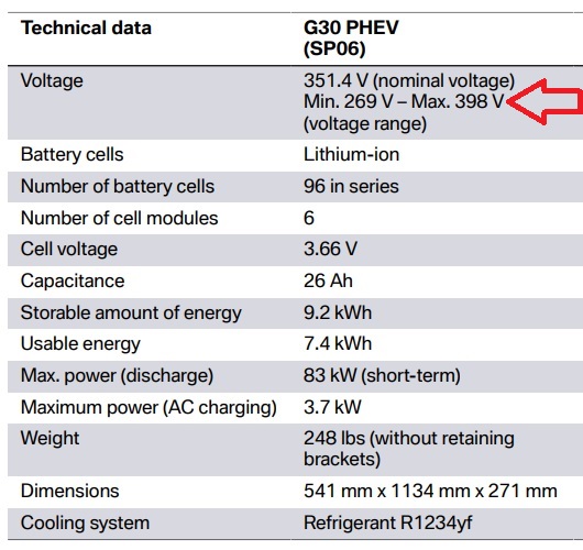

Think of nominal battery voltage - 351v, as being the in-between of max and min operation voltages
- Gregski
- Posts: 2873
- Has thanked: 530 times
- Been thanked: 1189 times
luv that explanation, makes sense to this brain, thank you

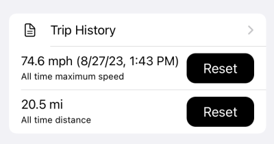

so got some numbers for you all after the first attempt at a Range Test, I say first attempt cause I did do some dumb things like try to get it up to 75 miles an hour for no reason on streets not freeways
so I ran out of juice after only 20.5 miles, but before you take that to the bank, we were NOT fully charged to begin with (maybe only up to 370 volts I forget, and fully charged is 398) and I only have one of the two battery packs that I own installed at the minute

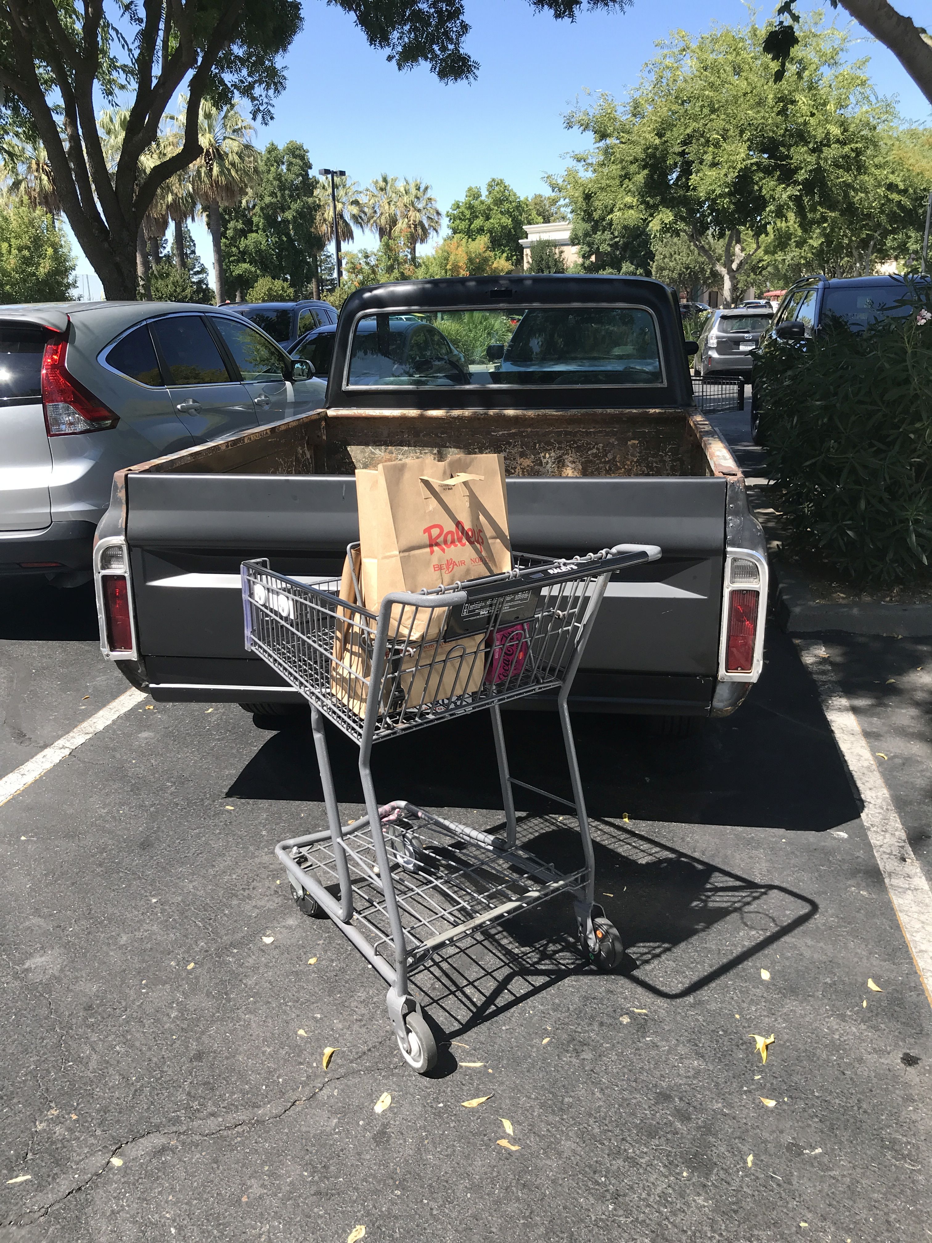

just an Electric Truck doing Electric Truck Things, jaETdETT:
Grocery Store: 1.8 miles away

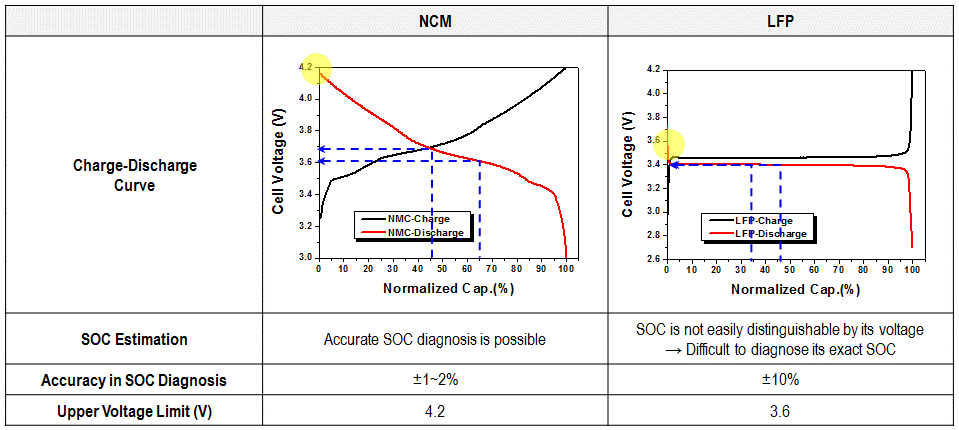

There's very little capacity at those low voltages:
source
I would avoid discharge below 3.30V/cell, it gets you very little benefit for a lot more wear / reduced cycles, same on the top above 4.10V.

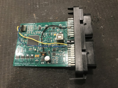

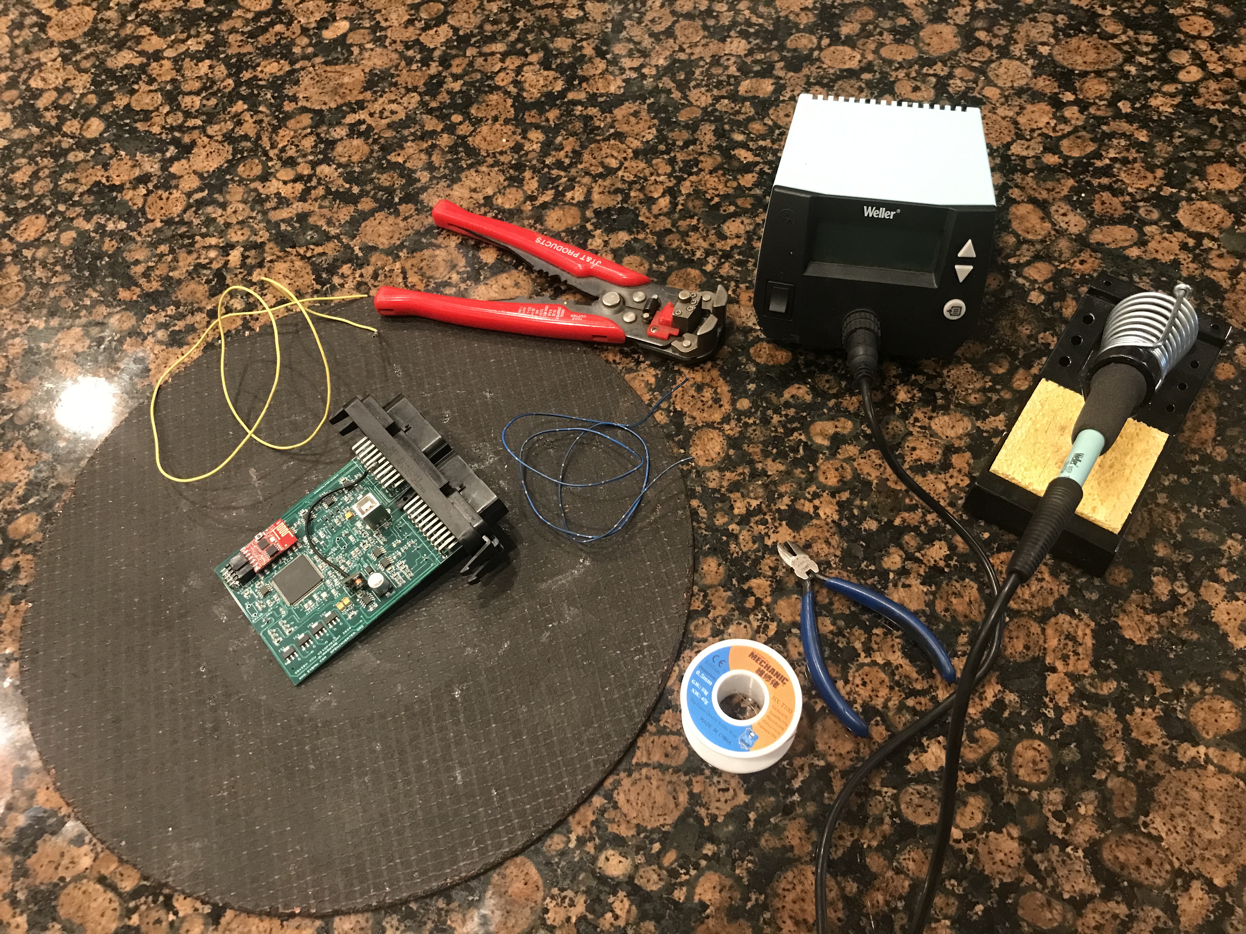

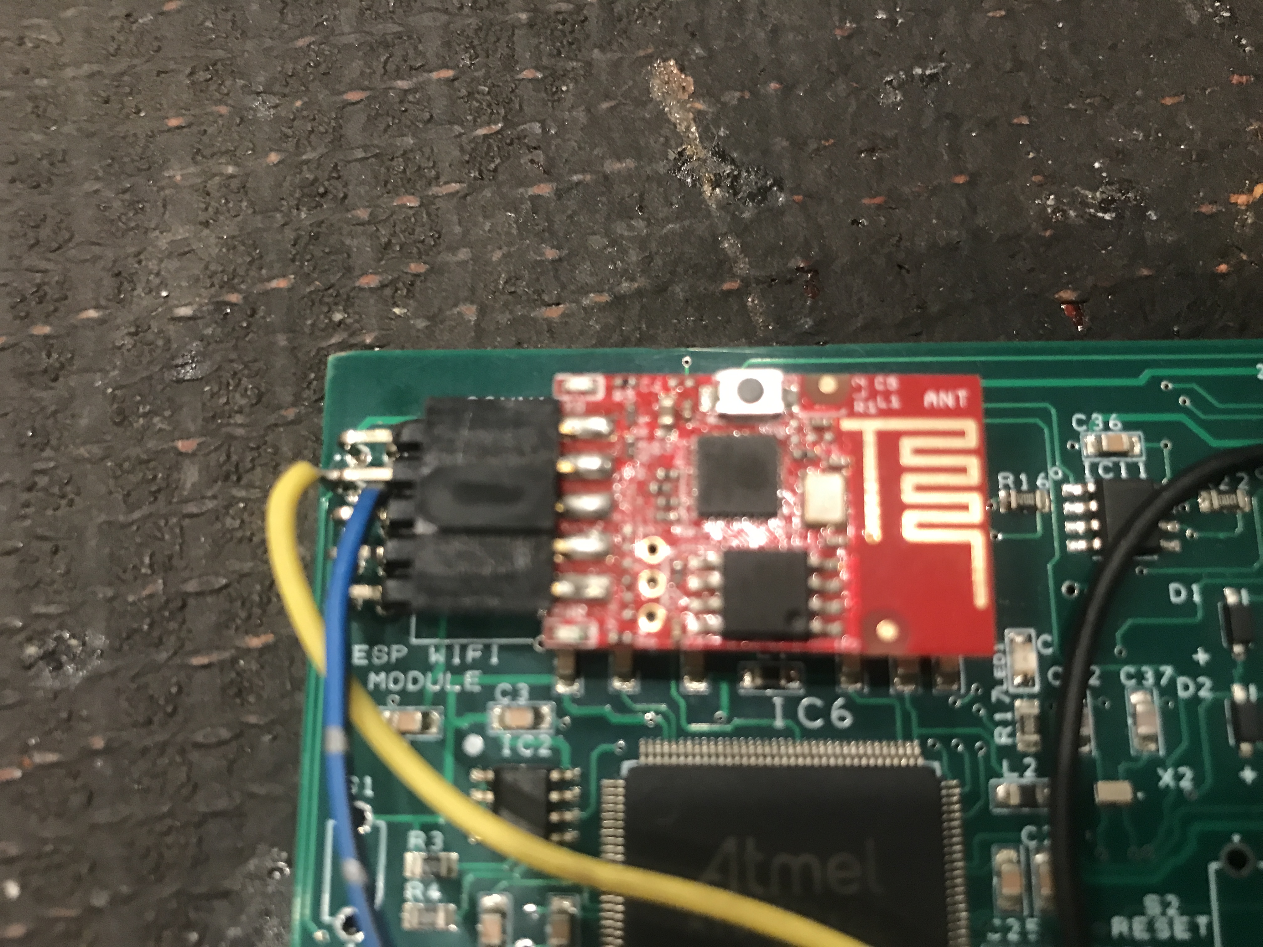

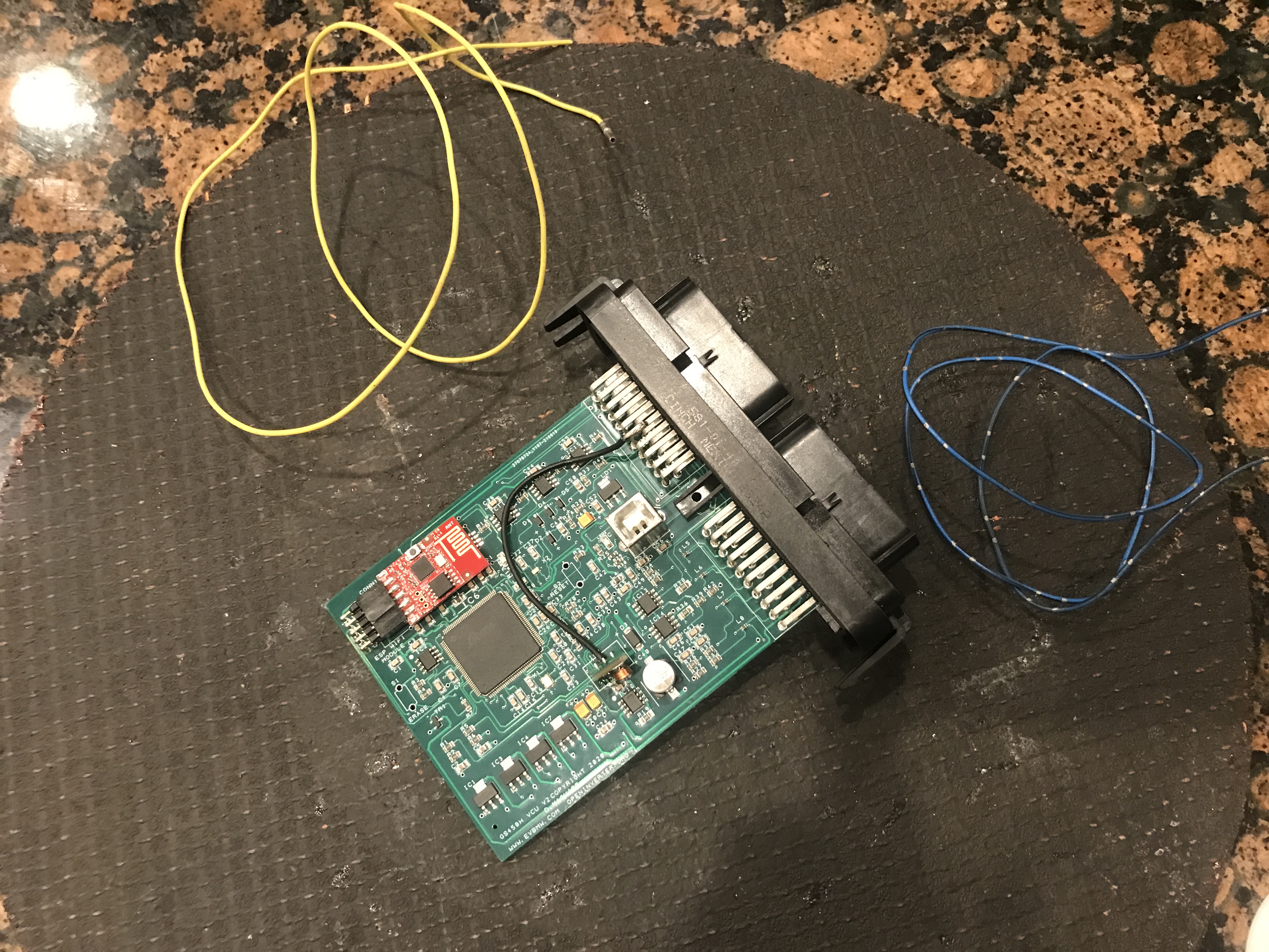

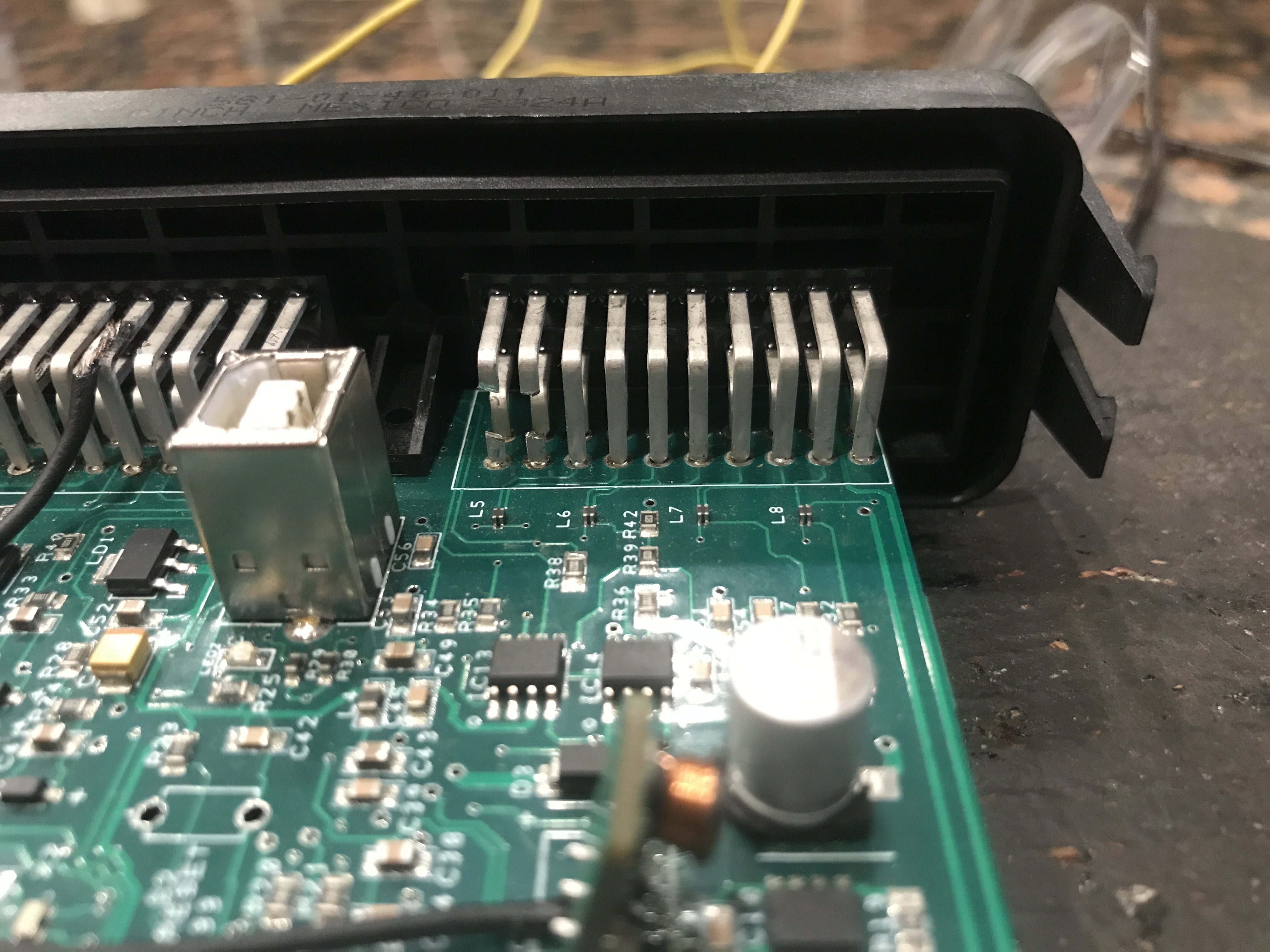

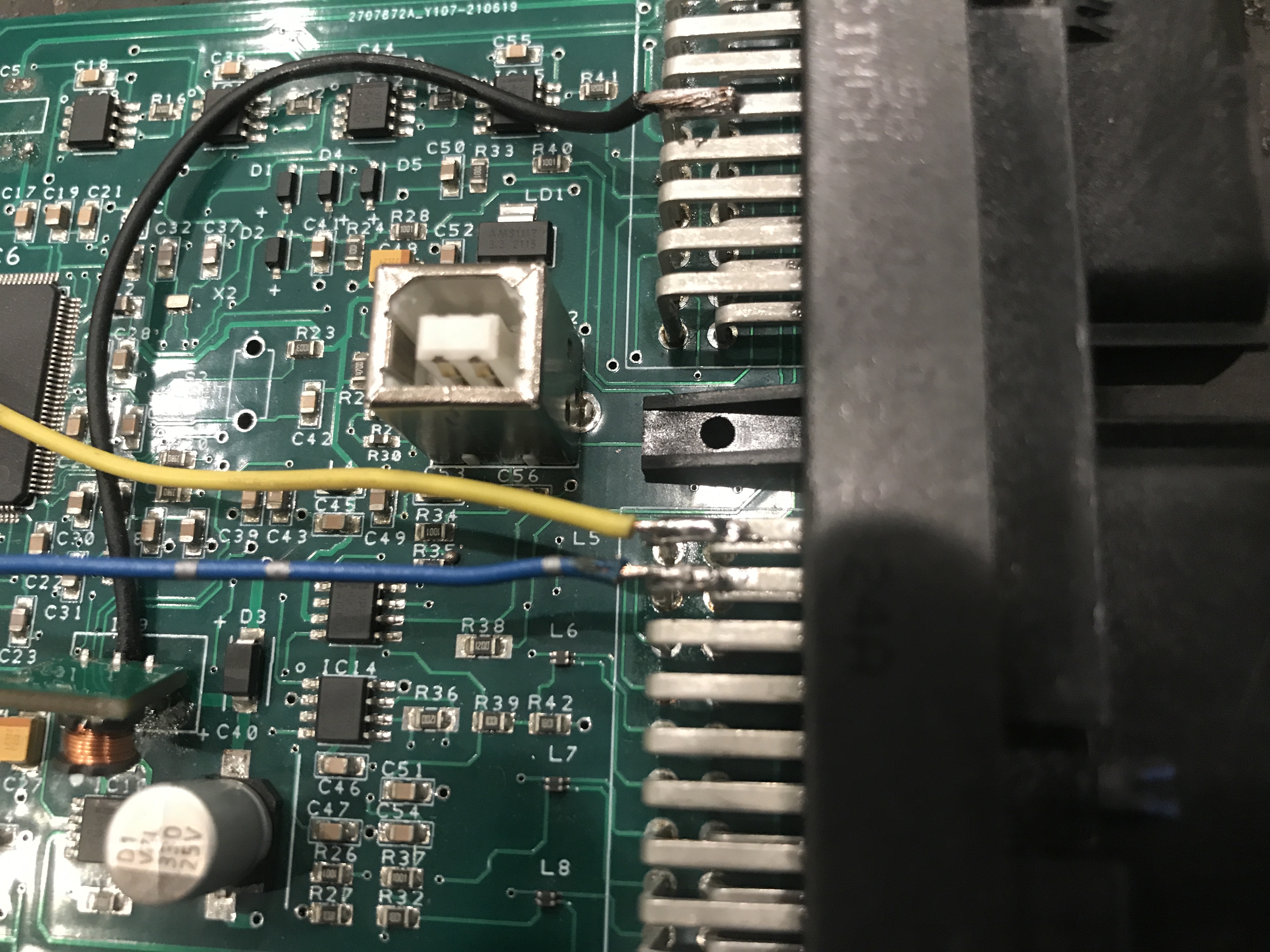

attempted a little silliness today to see if we could pipe out the data to the Nextion display actually using a couple non implemented connector pins
a little hack-a-thon on pins #9 and #10 of the A Connector
- Gregski
- Posts: 2873

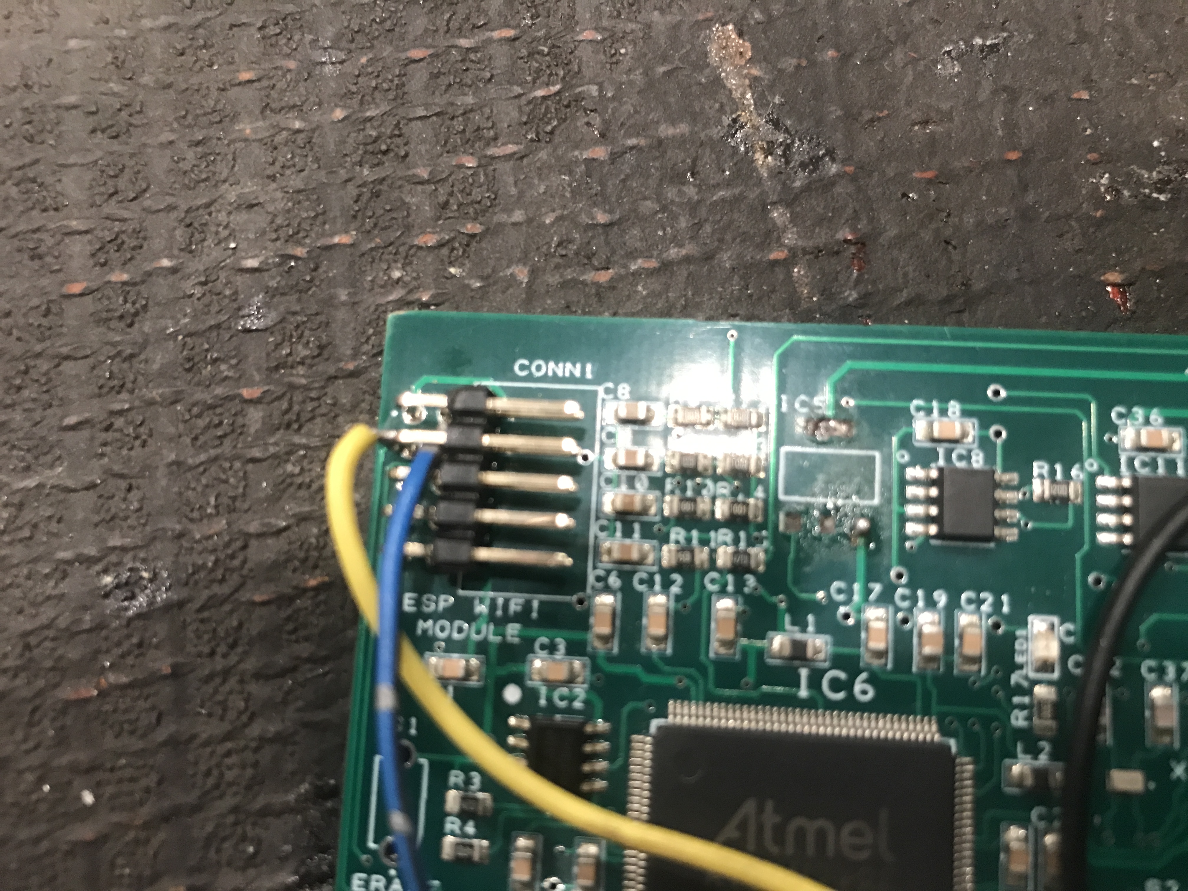

then it was time to link the RX / TX pins from the WiFi UEXT 10 pin connector to those on the A Connector
and we can still plug in the little red rascal if we want to

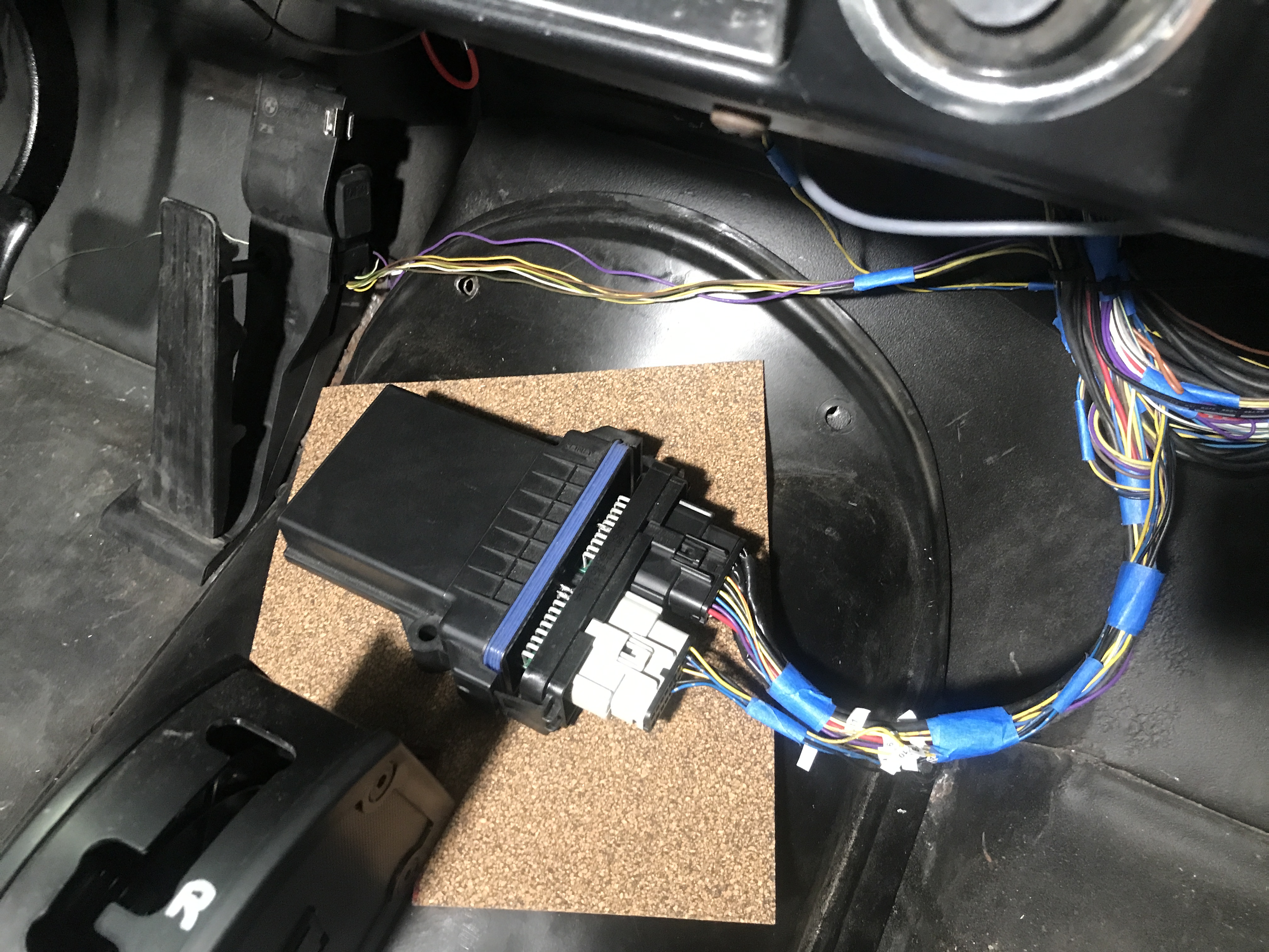

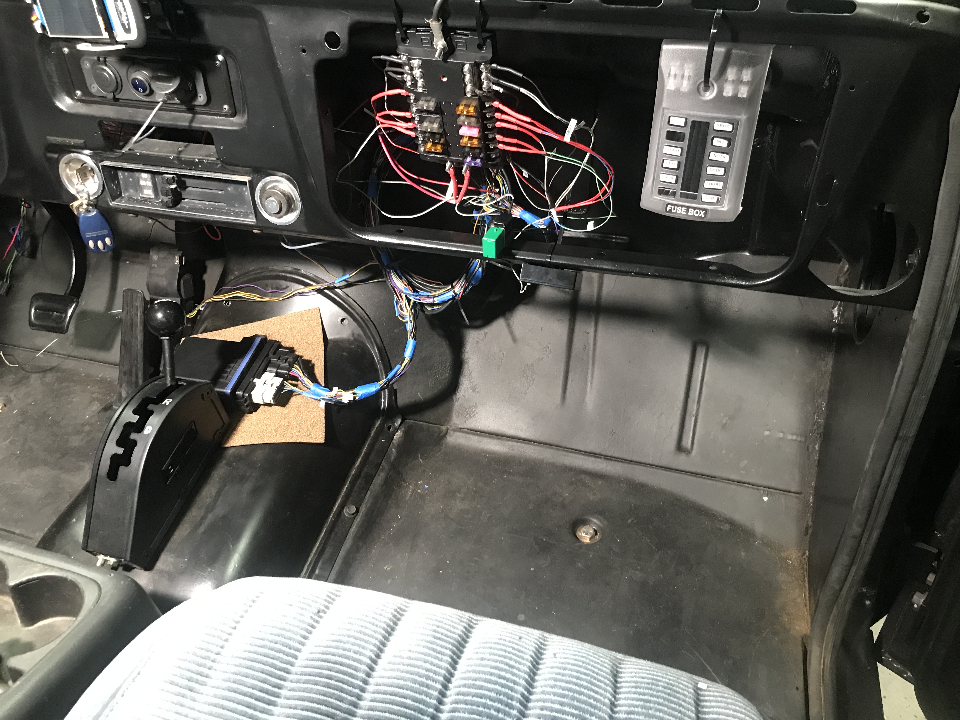

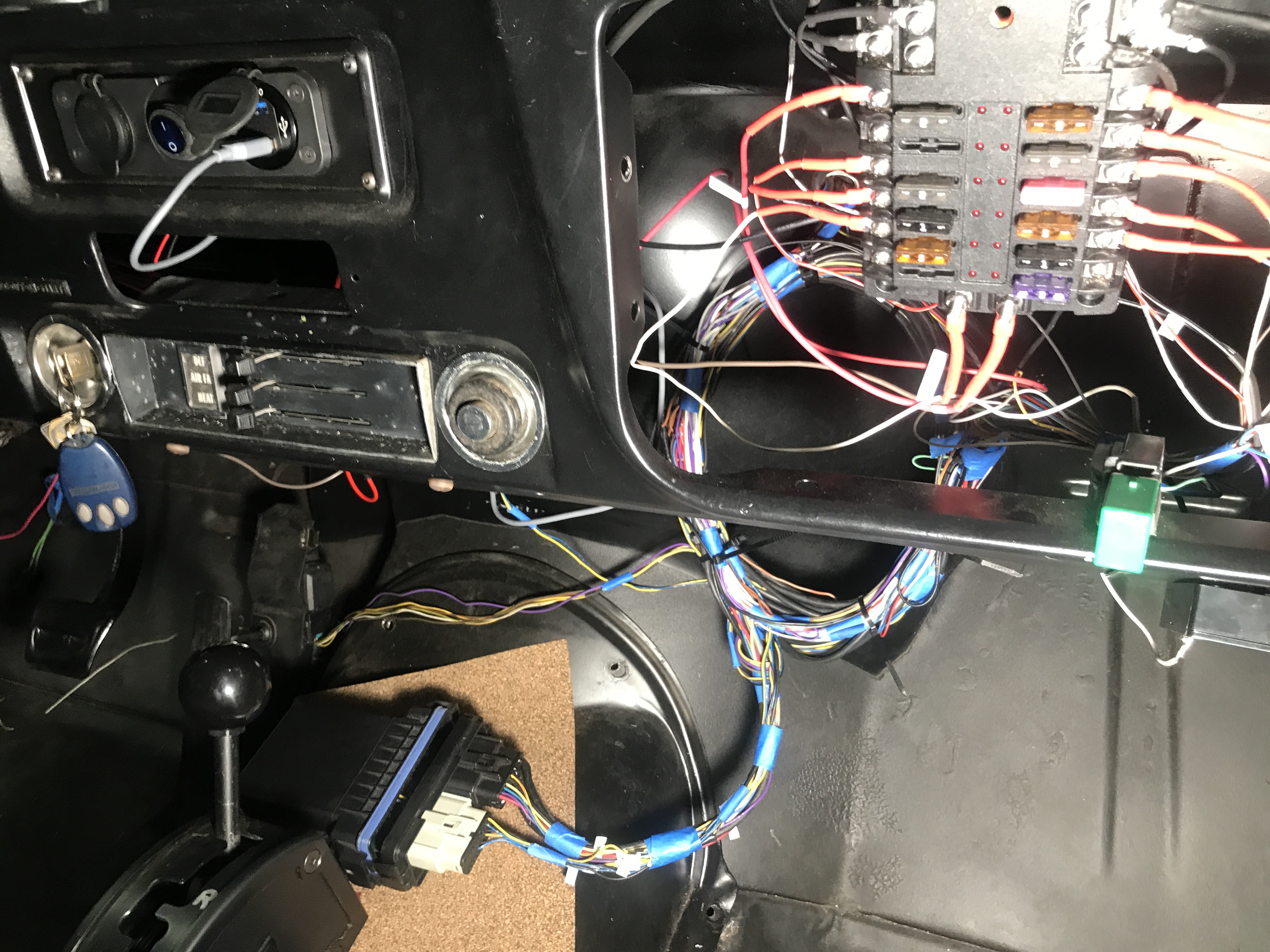

then I decided to thin out MY own harness, lol I'm a simple man and over the last two years I learned that repurposing pins on this VCU aint that easy, for instance I wanted a second PWM pin, no dice, I wanted I2C, no dice, plus I have a 1971 pickup so less means more
it aint there yet, but it's getting there, I still keep having reservations about shortening all the wires, so I just keep looping them still, but eventually I will cut them down to size, except for the synchronous serial bus ones them I will leave alone

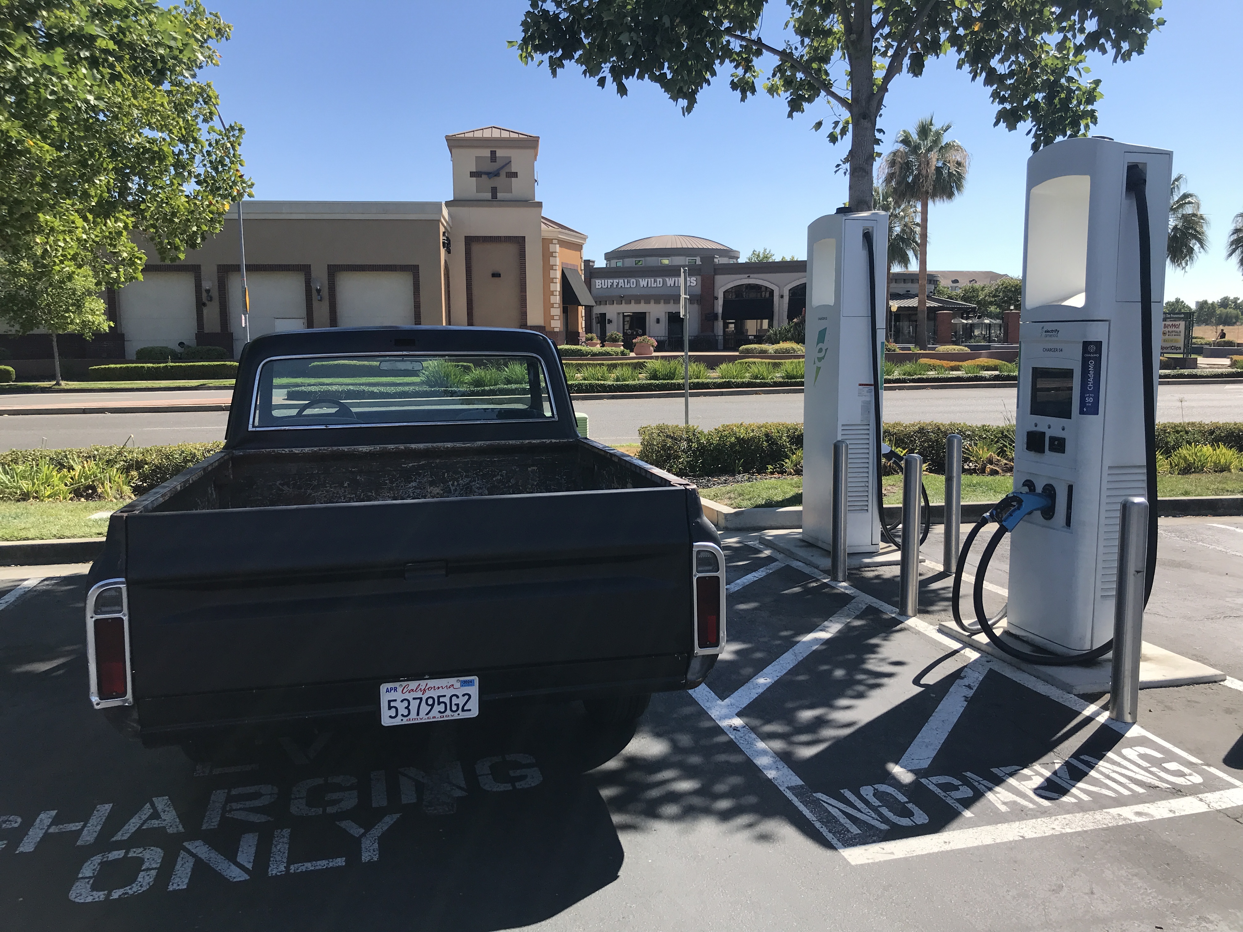

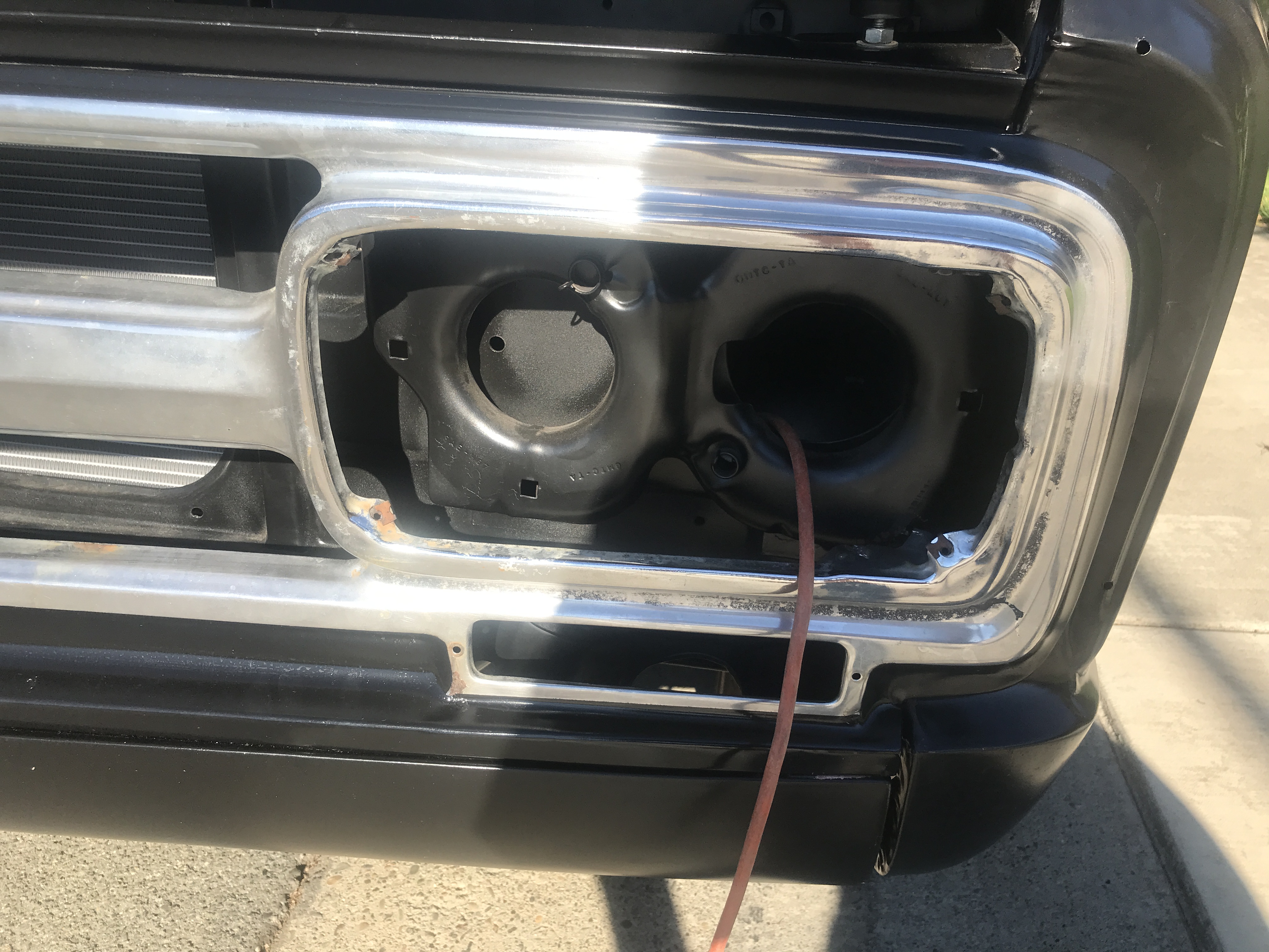

just visited a charging station for funsies, you should have seen the face of the guy charging next to me as I pulled up with this beater, unfortunately J1772 standard charging is not implemented on Dusty just yet
Distance: 2.8 miles away from my house
- Posts: 3660
- Has thanked: 145 times
- Been thanked: 369 times
Hah! What is priceless is some Tesla driver walks up to me charging on L2 EVSE and demands from me to move. Of course then i tell them this is an EV. You should see the face... "Oh really....?" My next question with an innocent face is: "Dont you have tesla charging station nearby...?"

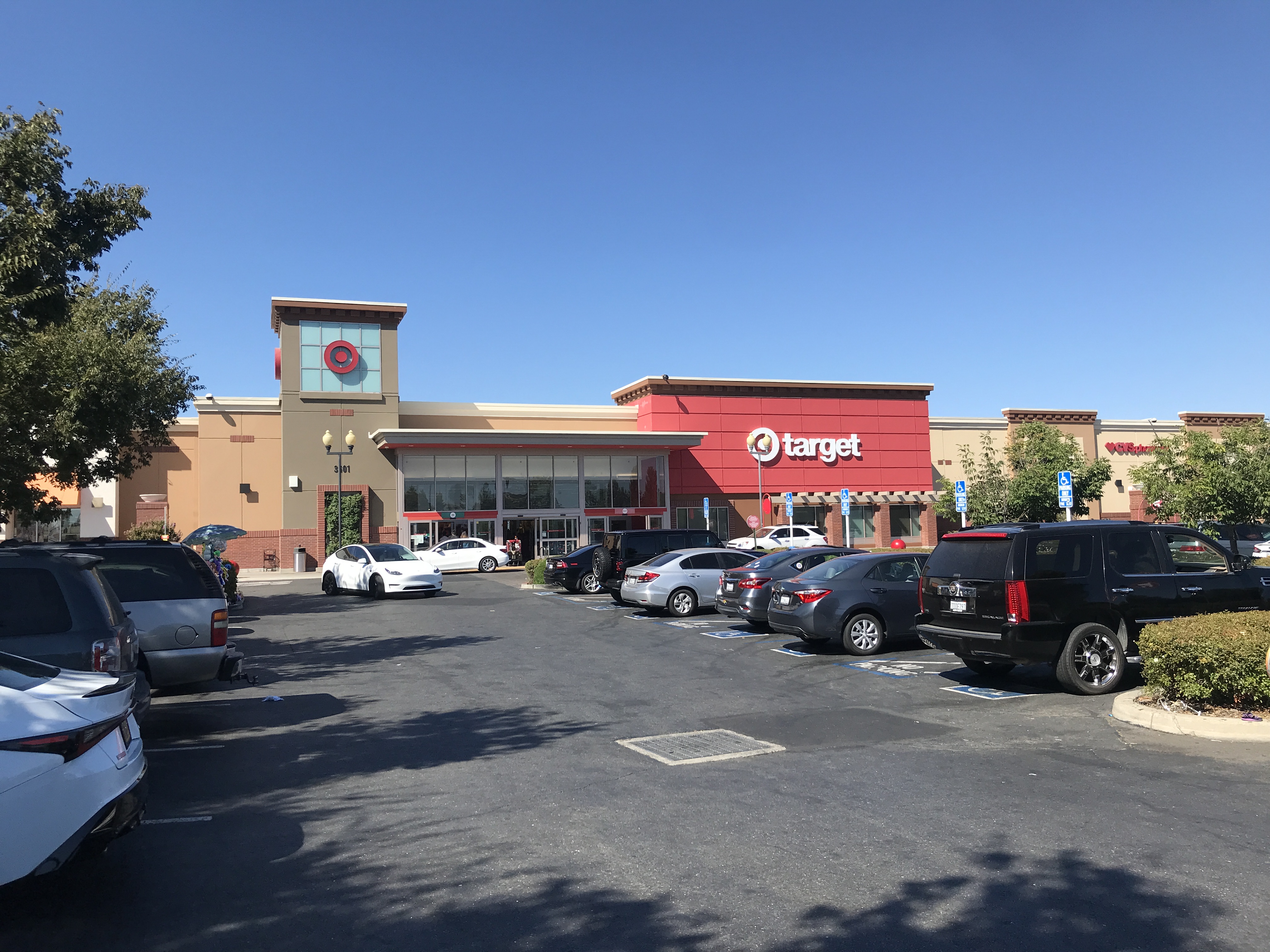

jaETdETT
TARGET: 2.8 miles away
man, she needs a new bed bad, but that's a project for next year, the greg is pooped!
