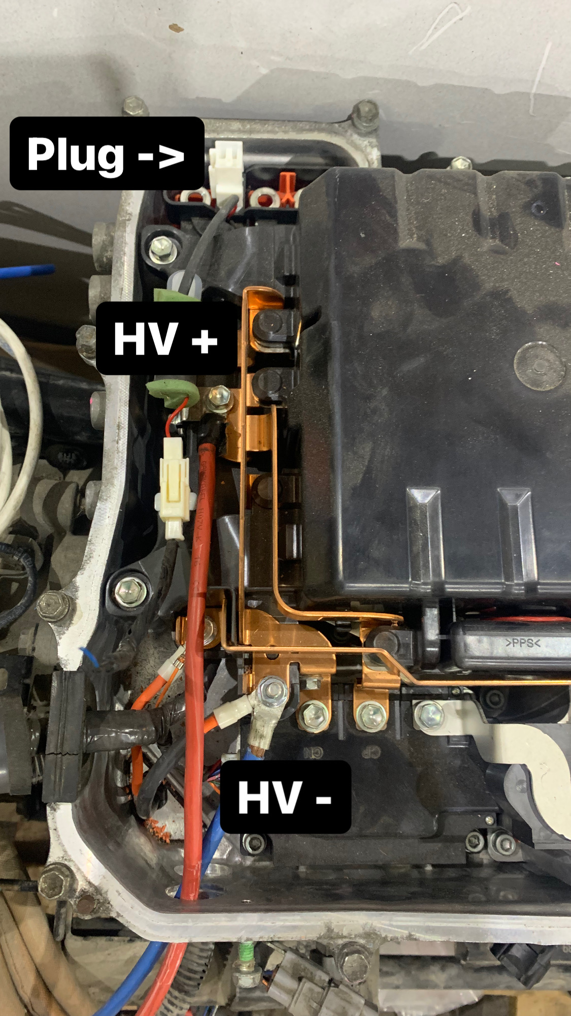

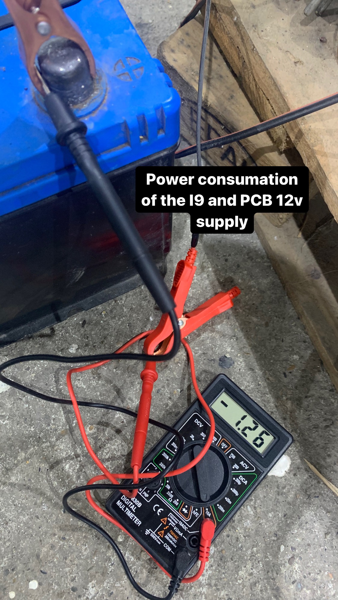

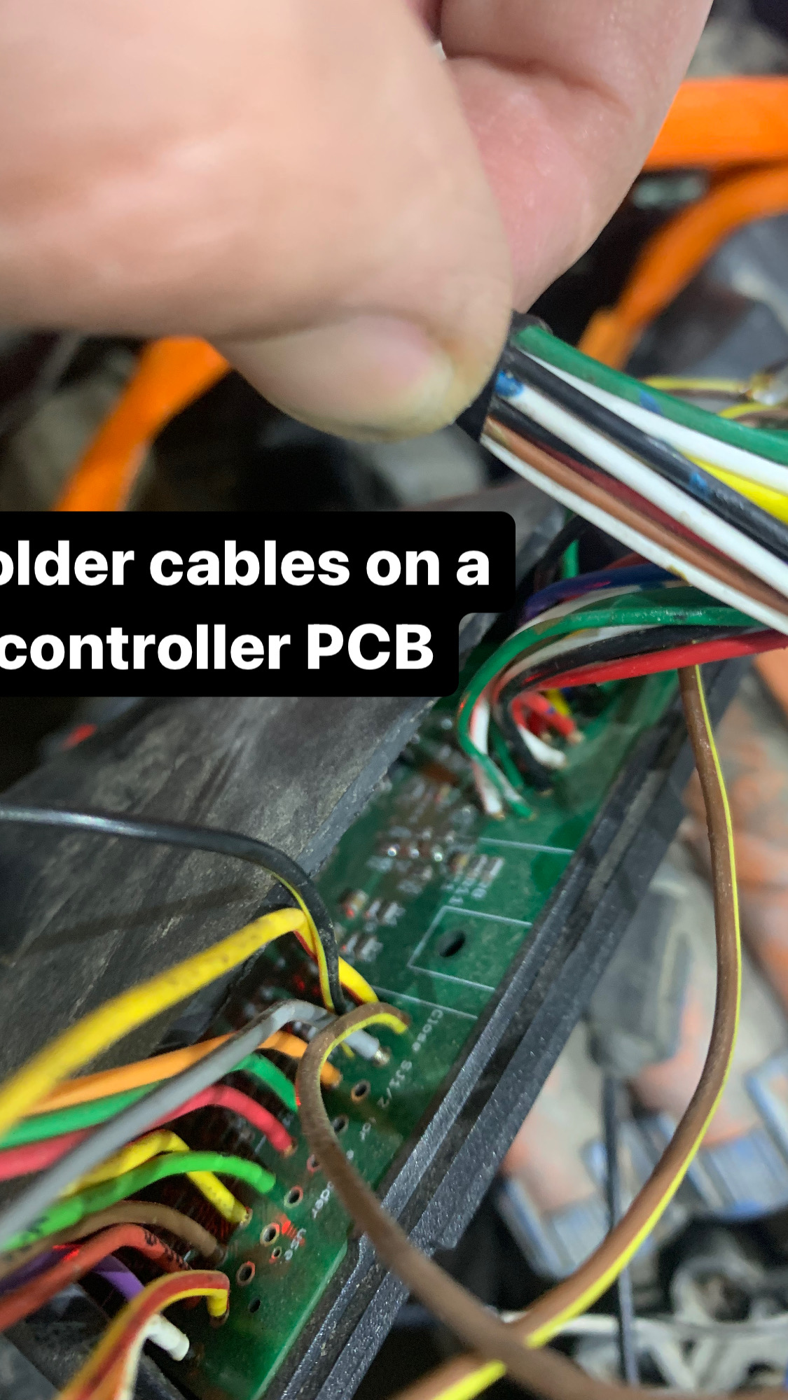

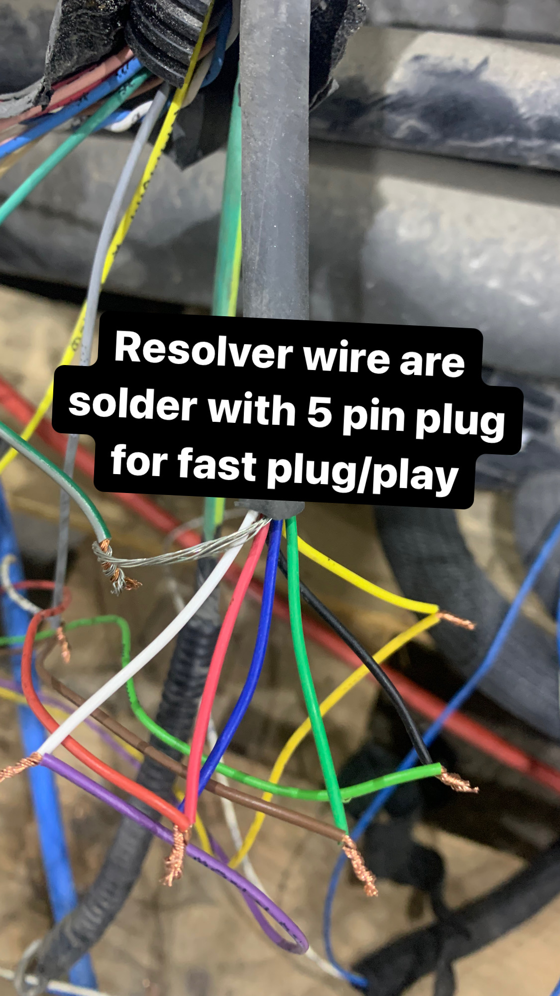

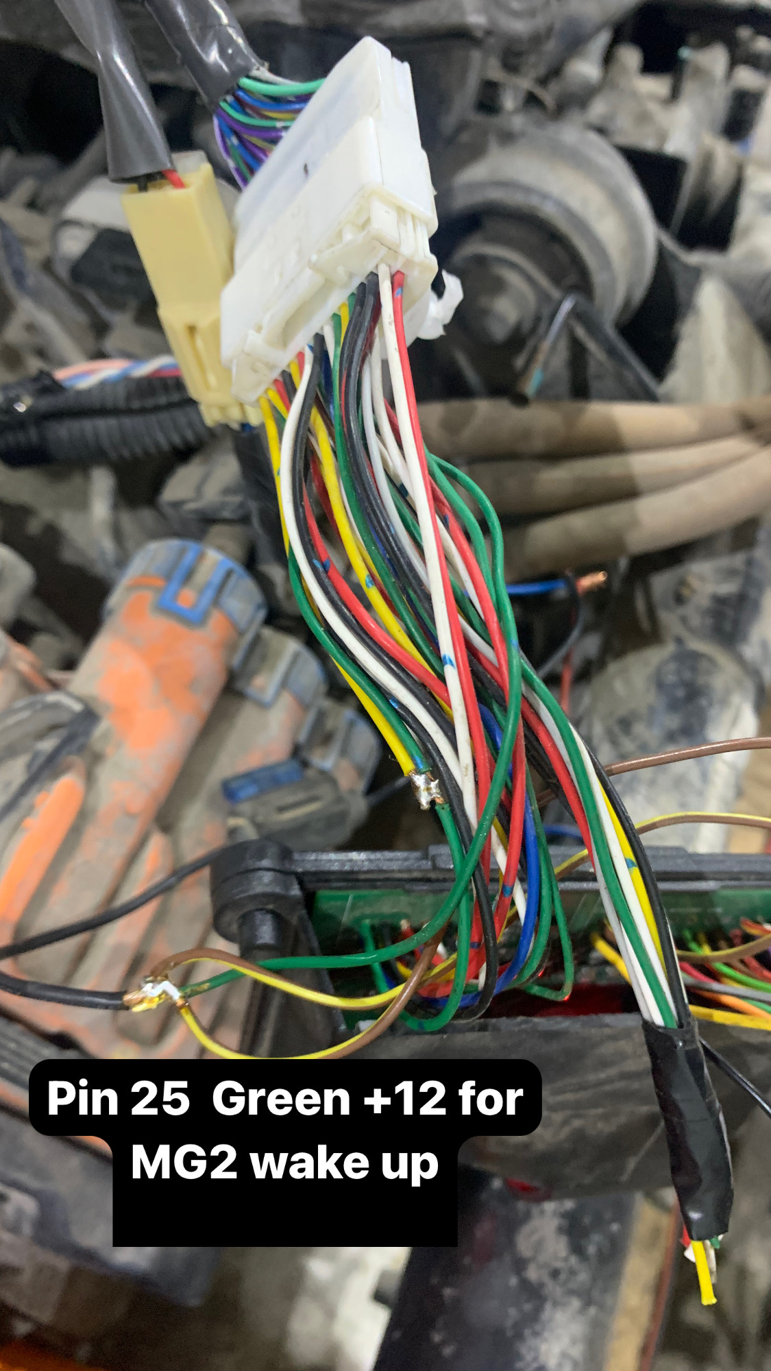

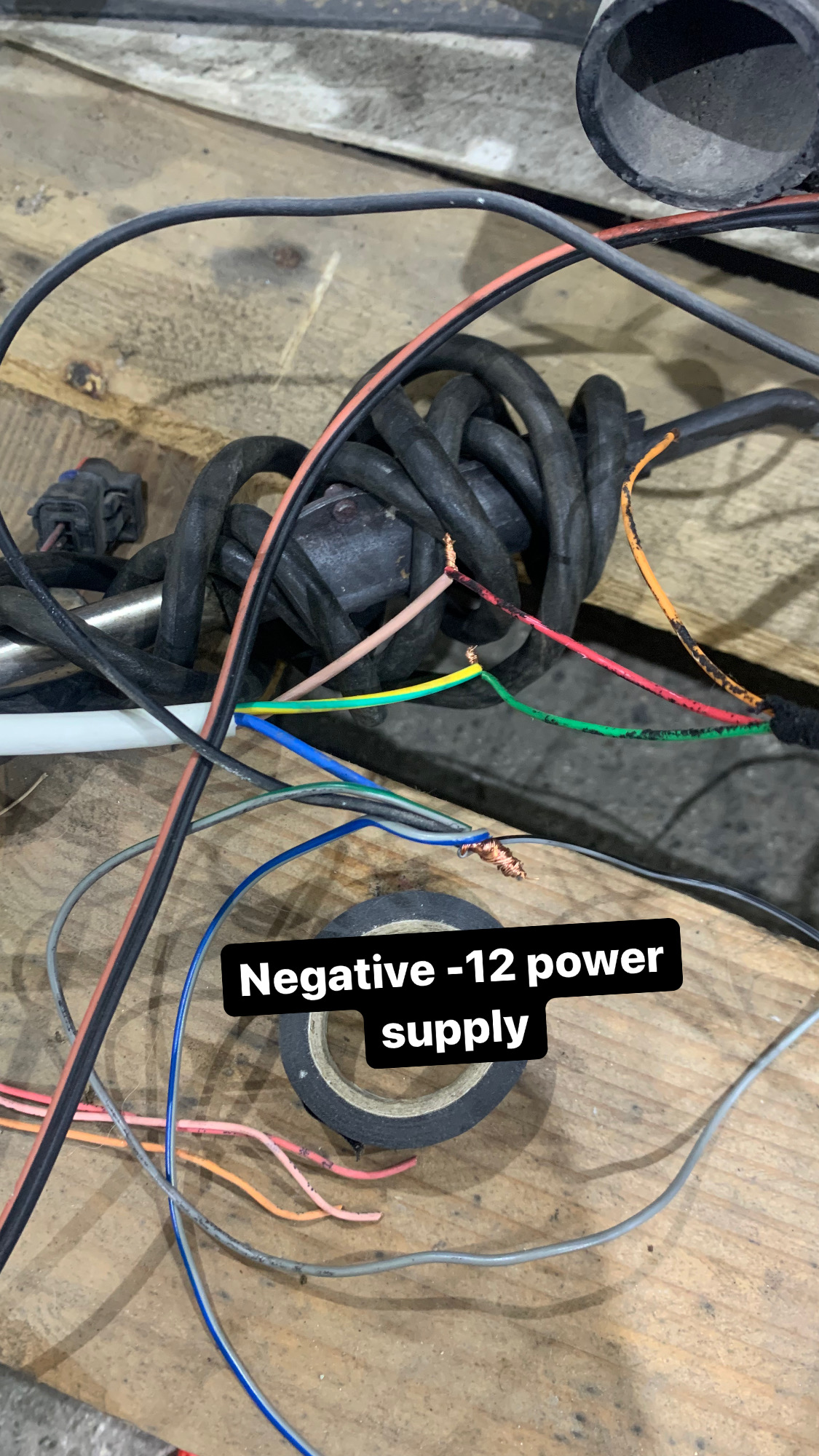

The motor is on a bench PMSM Bosch SMG 180/120 with resolver with Toyota Prius Gen 2 and Openinverter PCB of course!!
3 times watch the Video tutorial for FOC

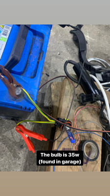

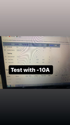

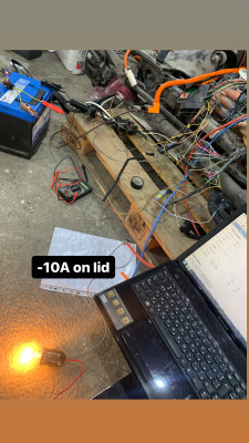

I do everything as a Johannes and D. Maguire said in video, but when try to Test the motor NOTHING, i make a couple of photos how i connect the Motor+Inverter+Controller!

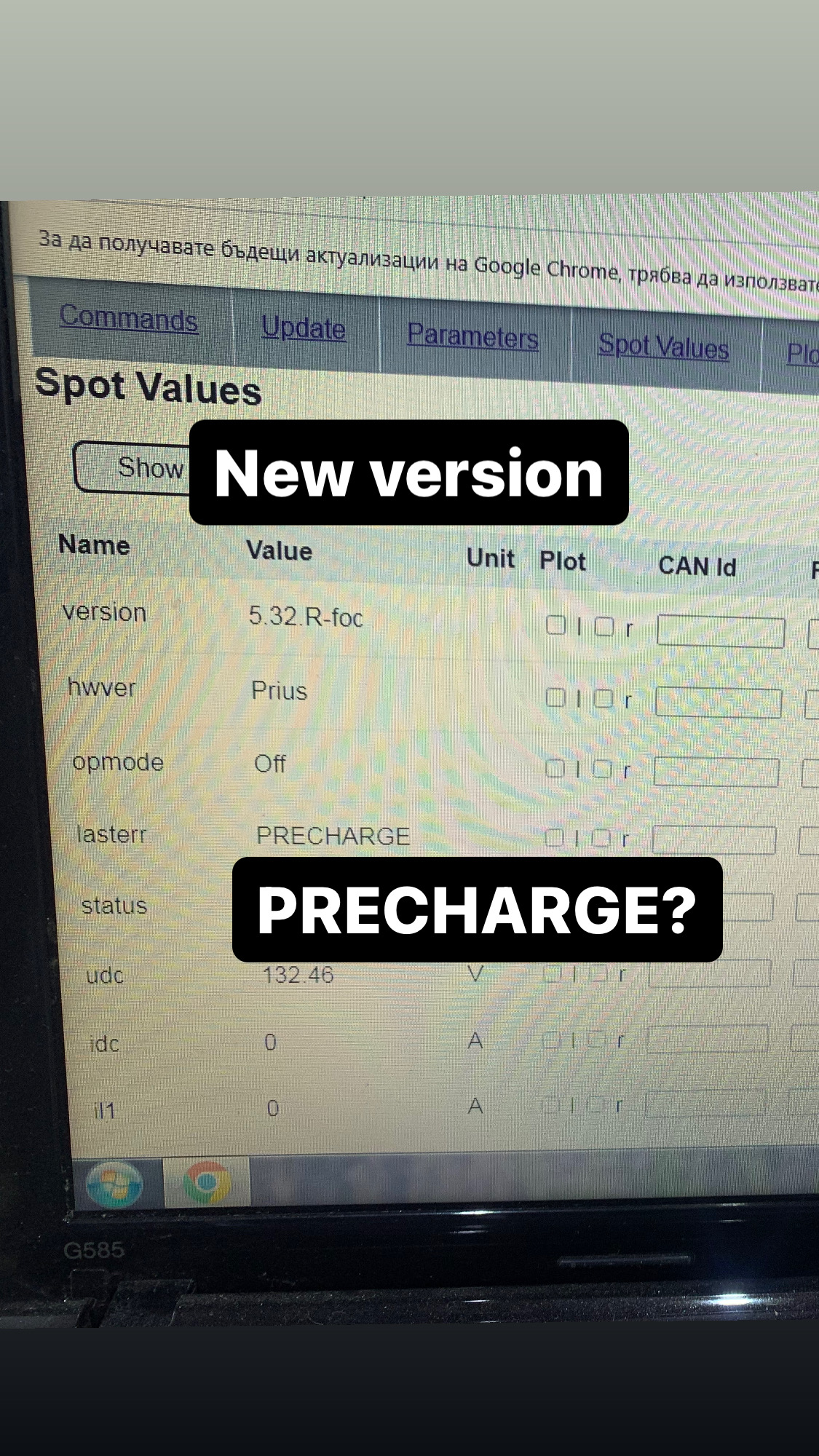

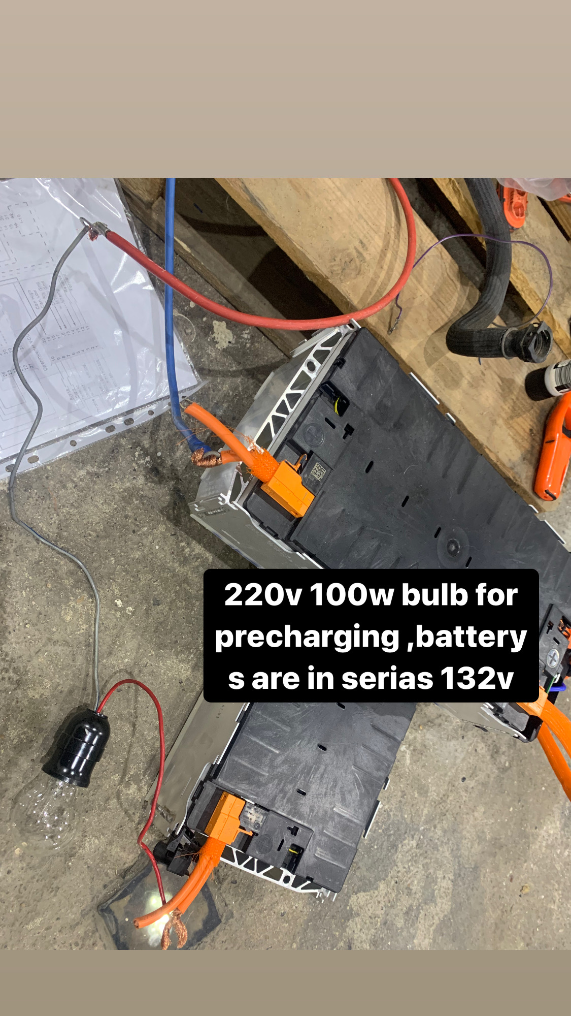

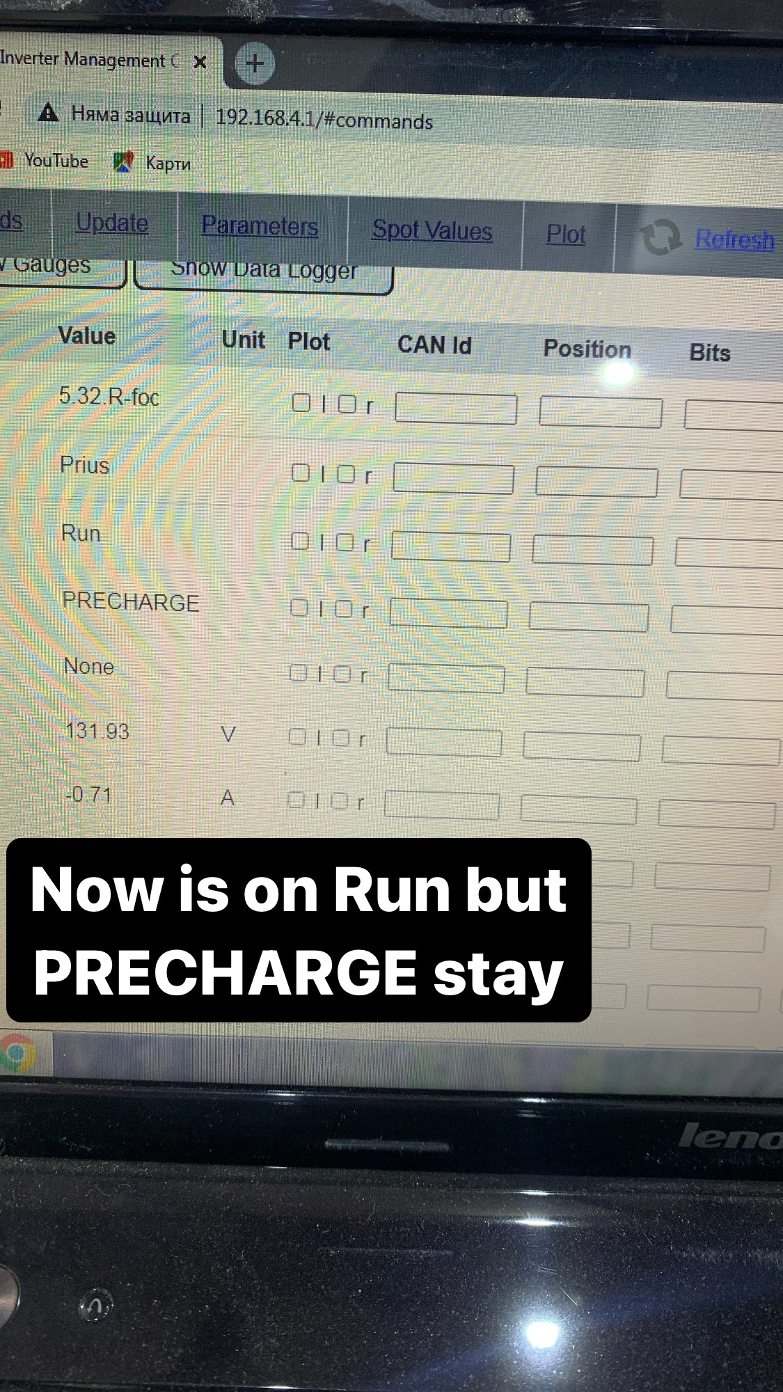

what isn't shown if opmode changes to run. If you did nothing about the PRECHARGE error then it won't. Lower udcsw to 100 and read here https://openinverter.org/wiki/Errors

After lower the udcsw to 100v show RUN and the 220v bulb rise up with -10A BUT PRECHARGING stay

Silly question: What is the condition to clear the lasterror? Does it need a power-off-on of the VCU? Or other?

I try 3 times to restart it off/on the vcu

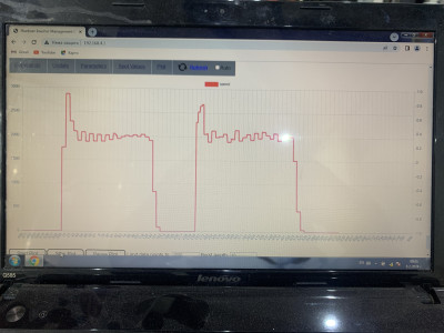

Hi, today after 3-4 hours working found that motor is not spin, i post the video because i can’t make photo, try to spin but have noisy vibration… What to do now, please help

Re: Peugeot Bosch SMG 180/120 with Gen 2 inverter
Id doesn't spin, iq does
Read this https://openinverter.org/wiki/Using_FOC_Software
There is only one correct syncofs, one seemingly works but misbehaves at higher speeds the other spaced 32767 apart is then correct
If you never get any spin resolver sin/cos is swapped. You can set pinswap=7 with custom command to try that

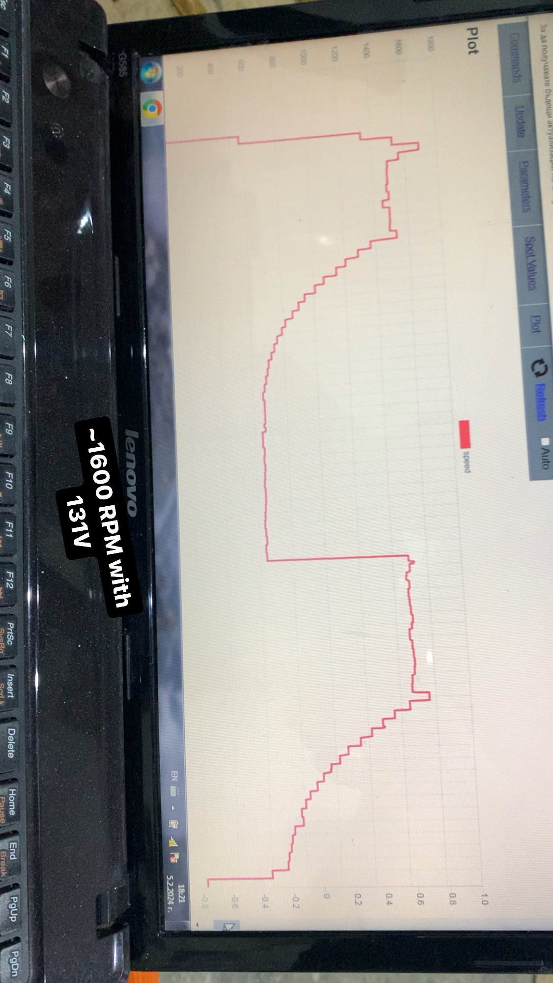

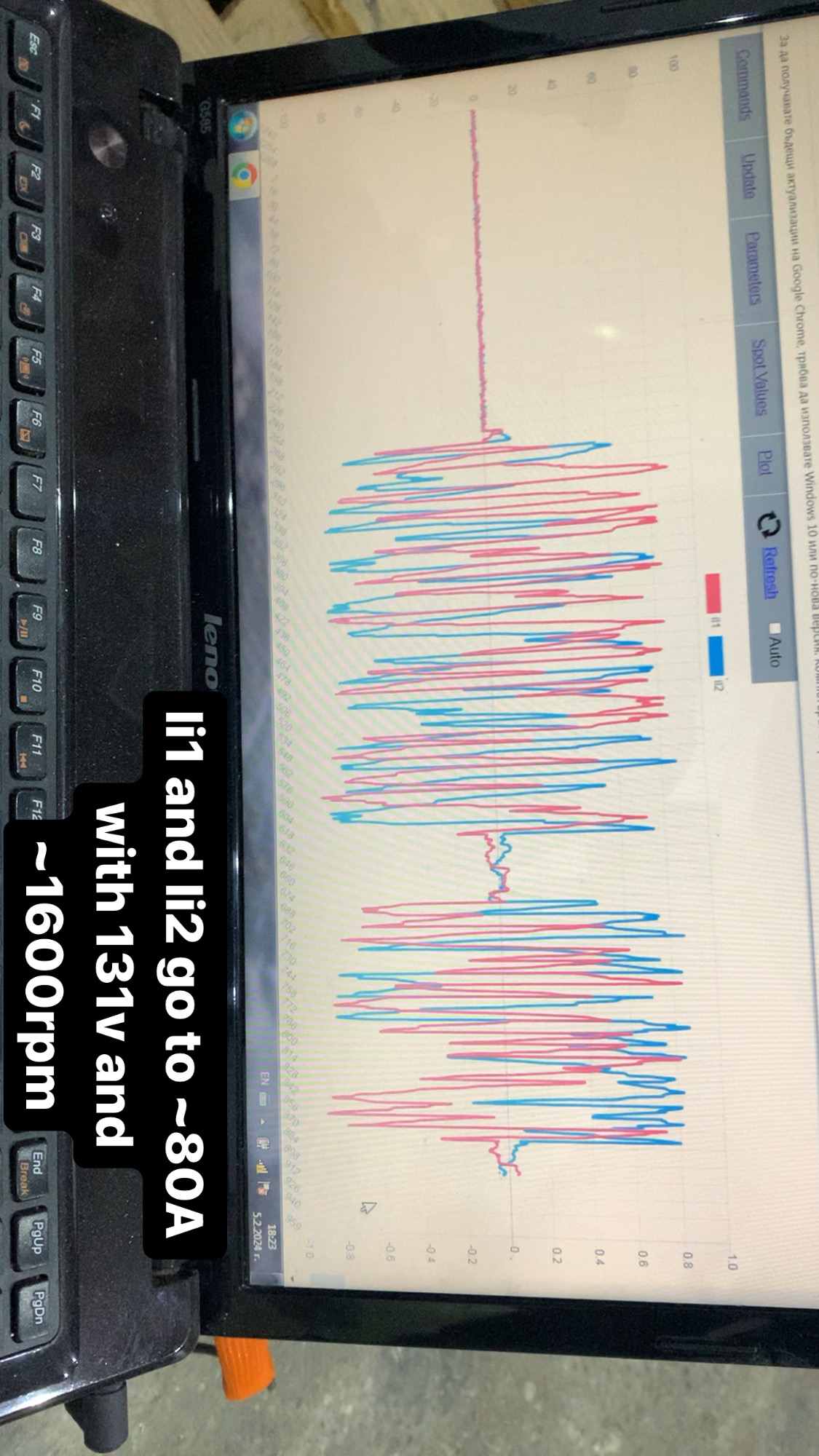

WE DO IT!! change the “respolepairs=6” and “pinswap=7” the motor spin very well.(will upload a video in youtube)
First test:
Voltage 131v
The motor go to ~1600rmp with il1 and il2 to ~80A
131v X 80A = 10 kw ~13hp
Second test:
Votage 198v
The motor go to ~2200 rmp with il1 and il2 to ~24A
198v X 24A = 4.75kw ~ 6.2hp Why why why
when select the direction with +12v on a PCB the Forward spin in reverse and reverse spin forward they are swapped.
Also when remove the direction switch on “reverse” position the motor continue to spin with high rpm and can’t stop only way is to remove the power supply.
The parameters that i need for this rear axle is 200v 100A and 2500 rpm, what i need to calibrate first, now the motor is not load…

To calculate power input use battery current not phase current. From your rpm/Volt figures I would speculate that your syncofs is not quite correct, retarded timing I suspect.

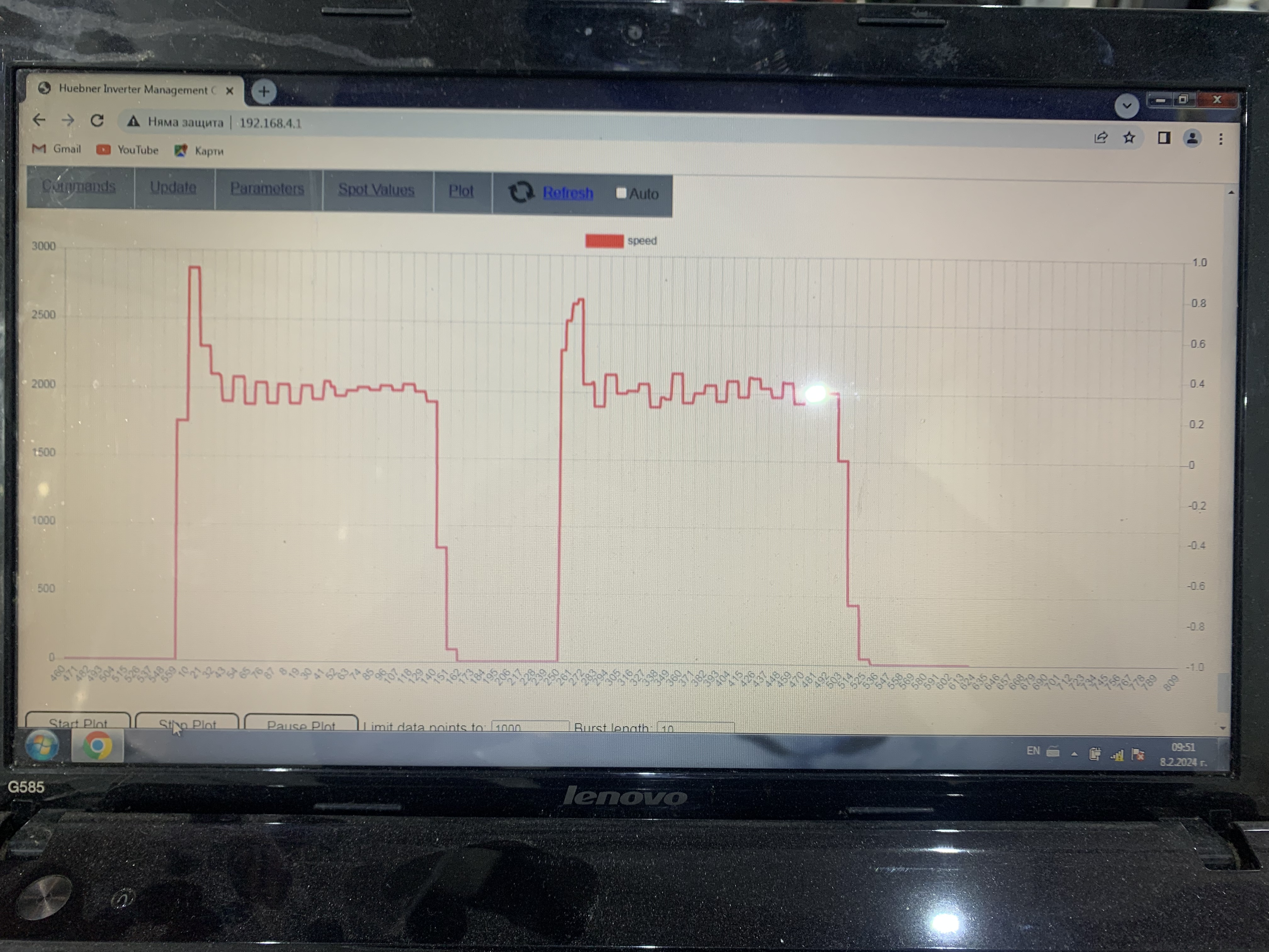

Replace the throttle pedal with new one but is some, when press just hit 2200-2300 rmp but not smooth rotation, when change the “throtcur=3-4 or 5” the motor just stuck and not rottate.
- Posts: 6735
- Has thanked: 378 times
- Been thanked: 1559 times
It looks like you're hitting the rev limiter (fmax).

Correct! Thank you, change the value to 400Hz on “fmax”, hit 4000-4500 rpm, but when release the throttle continue to spin with high rpm, aslo in a middle rmp stuck.#bosch SMG 180/120

Post your parameters.
I suppose you activated field weakening. On an unloaded motor the residual torque can cause what you observe
